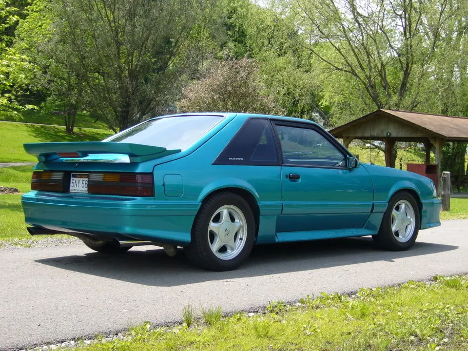

Thiss car has the 3" kit

its not a 3" catback... its just the pipes out of the muffler to the bumper

i have the full 3" flowmaster exhaust from the headers out the tailpipes and i have no issues with clearance at all anywhere other than the ground. the rear section goes over the axle differently and actually fits better than the stock style routing.
