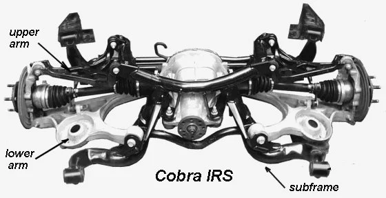

yeah I'd like to weld my MAC mufflers in front of the axle if possible and then weld the tips that were on the mufflers on the piping coming our the rear. I wonder if you could route the pipes under the Axle like the Terminators?
Being a live rear axle, it wouldn't work when you went to jack up the car as the axle will come down and hit the pipes. To have the pipes low enough you would be looking at some serious ground clearance issues. It worked for the IRS due to the pipes running just under the rear differential which did not move.
