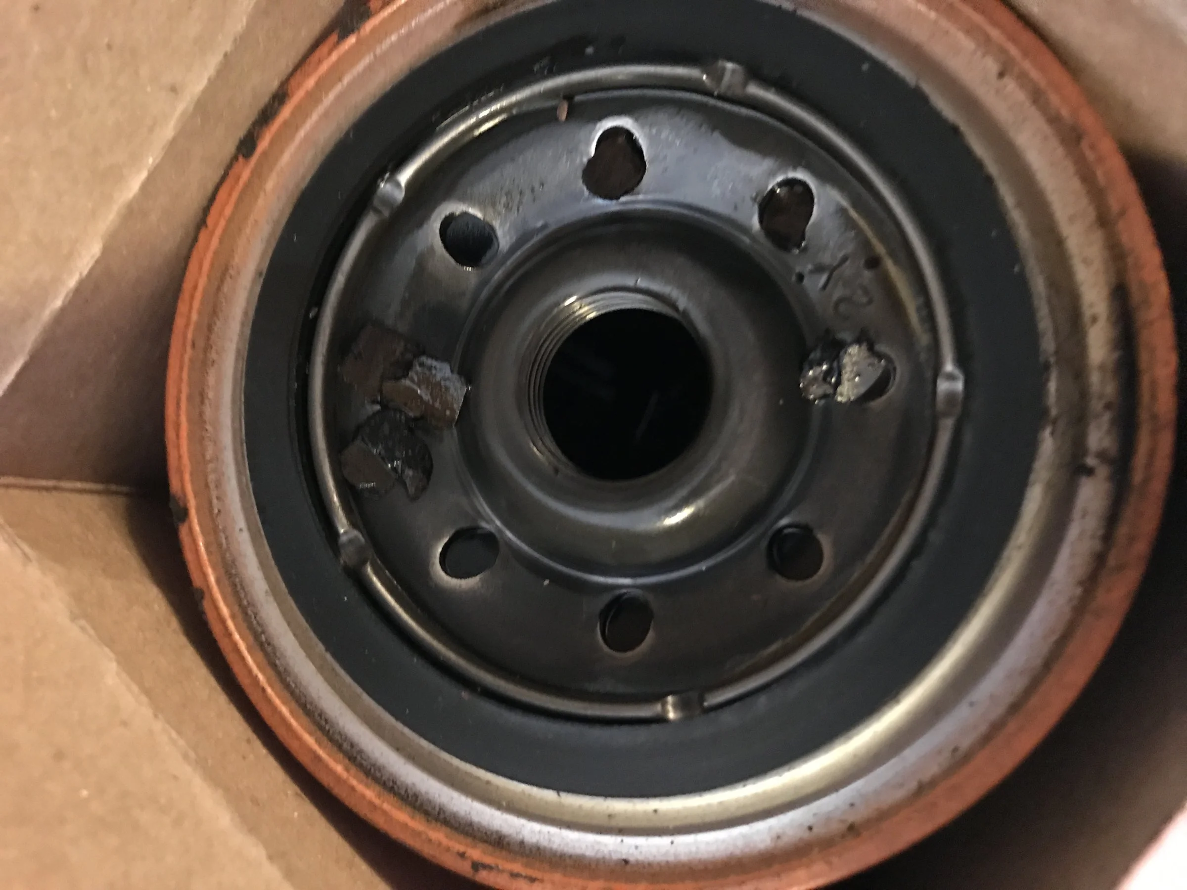

Hope some can help, freaking out about this. When changing the oil on my 89 LX the oil filter had debris in it. I have attached a picture, am I in trouble?
Are those actual chunks of metal? Can you pull them off and put on a paper towel for better look? Also, cut open the filter and see if there is more metal chunks inside.
Kinda looks a bit like crumbled gasket material, if it's magnetic you could have an issue but like others said you need to cut open the filter to see what else is going on.
