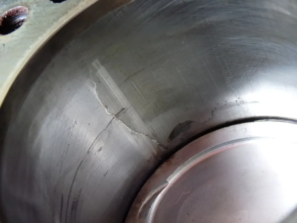

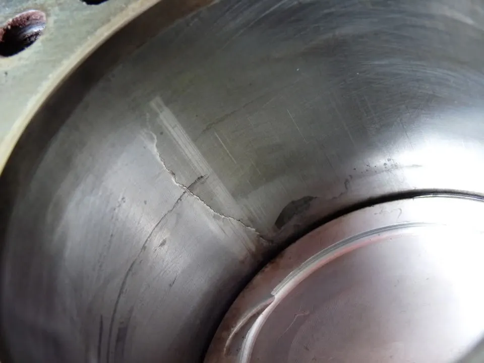

This is what a failed block looks like: :D

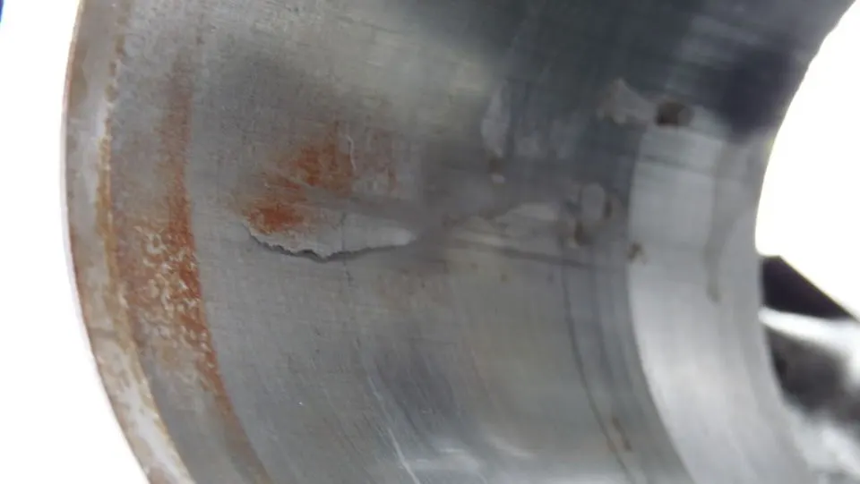

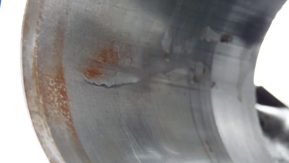

After pulling the piston out:
Yes, I cracked the block. It was ~25psi of boost and a 70 shot. I really should have done a half-fill on the block, but ohh well.

How did you manage to crack a 2.3 block?
Some of them had a core shift problem, plus I bored it .030 over. 25psi and a 70 shot doesn't hurt things either. It was actually a slow failure. It started by just using a little coolant and being off a few ticks at the track. Then one pass, it let go and still ran a mid 12 something. It puked coolant out the overflow can from pressurizing the cooling system under boost, and mixing fluids. The poor engine is tough though... I grabbed a gallon of water and drove her home from the track.. about 30min. I stopped once to top off the water, and aside from a miss at idle, she did fine.
