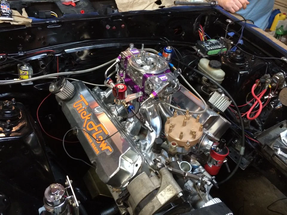

I have a 87 5.0 with all new everything. Trick flow heads,cam, full msd,proform carb, Parker high rise intake. My problem is a miss fire that sounds like my two step is on when it's not. It will idle fine and full pedal fine but any thing in between is bad. I checked timing over and over. Put a new msd box on new plugs and wires. Checked for vacuum leaks camtiming. I've done every thing I don't get it
