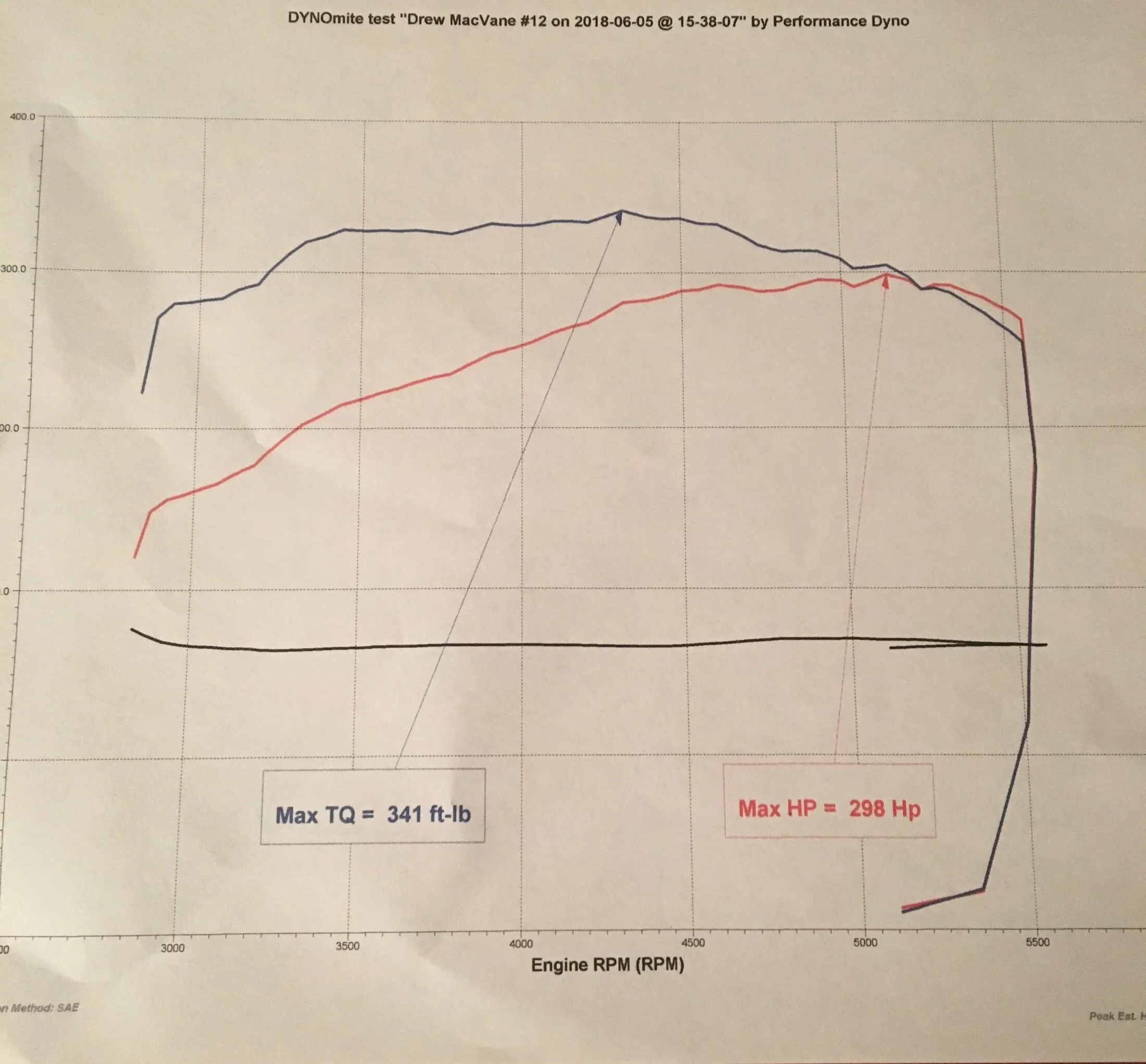

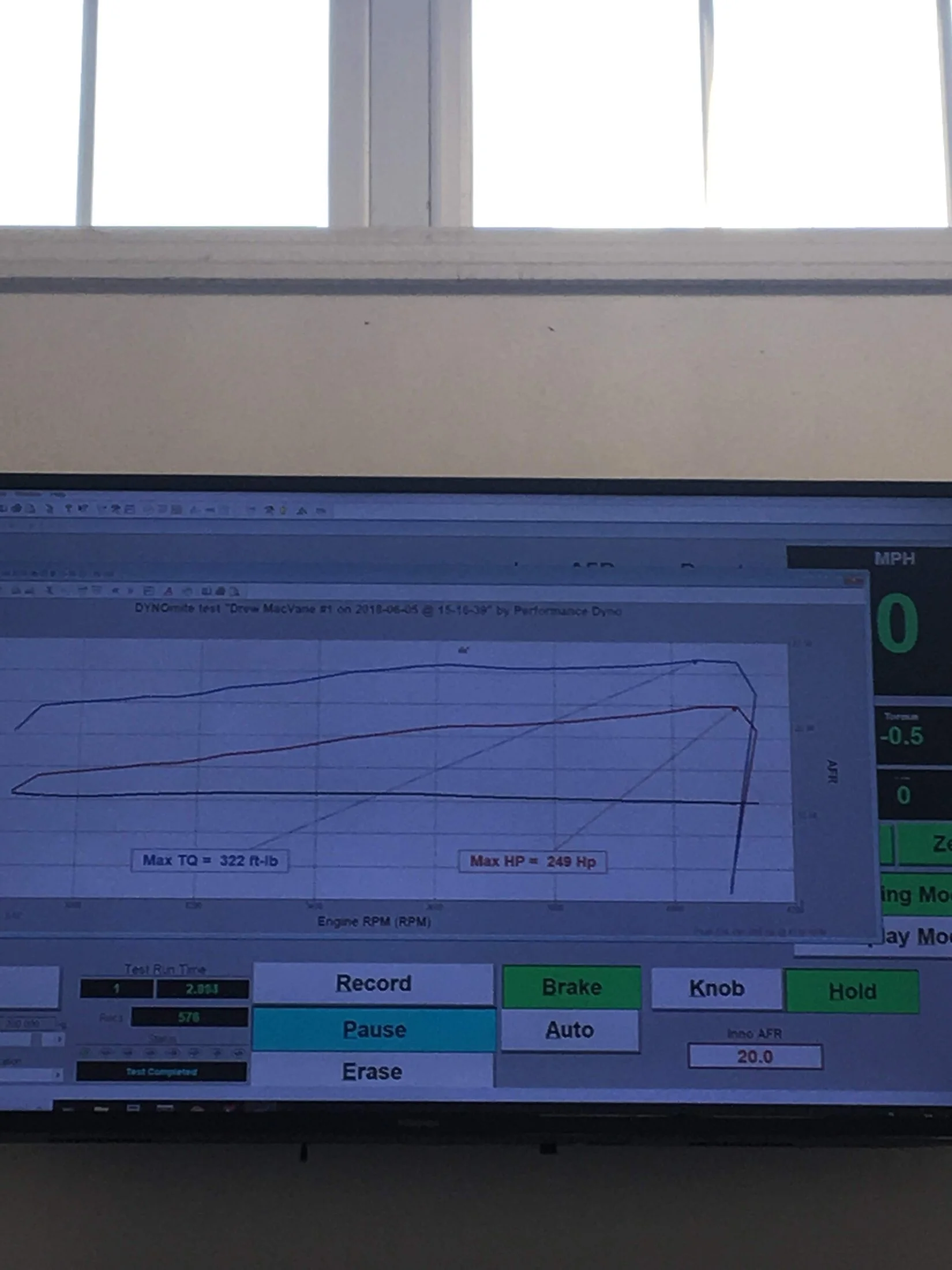

No offense taken, I didn’t build this engine. In fact, I don’t even know what cam is in it. I’ve often wondered if it’s an Edelbrock as both the heads and intake are. Either way, I’m very happy with the performance, both NA and now with 6psi.
