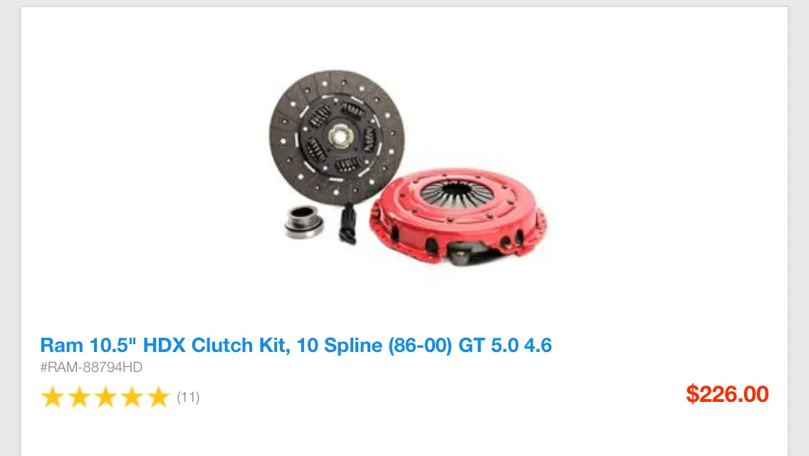

Can't recommend a RAM clutch highly enough. I like it waaay better than the king cobra it replaced. Now I only have a few hundred miles on it so i can't say it will wear as well...but pedal effort is better and it grips hard.

This...
I wish I had taken pics of my Cobra after only 5k miles and a few nitrous passes...it was done. Don't take me wrong it's a tried and true setup..just didnt like the pedal effort as much as the HDX. Centerforce makes a decent clutch but have read more negative comments the last couple years. McCloud is good also.
