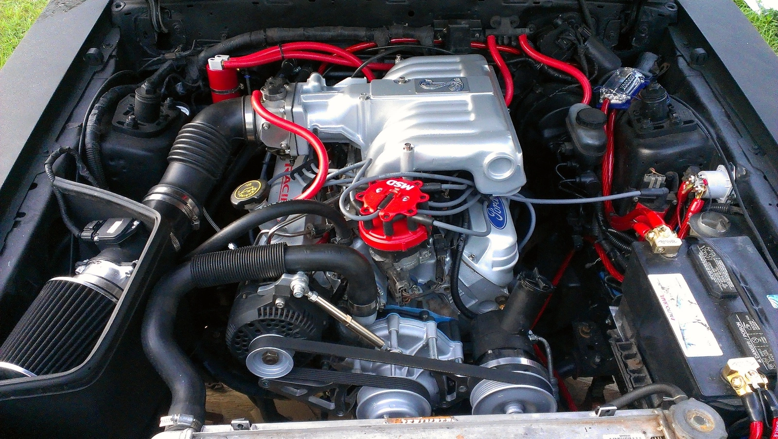

ok so i rebuilt a 302 .030 over new pistons moly rings and kings bearings. i reused the factory lifters, ported gt40s and e303 cam with 1.72rr. i adjusted the lifters with shims before starting the engine. it has 65 lbs of oil pressure but smokes pretty bad after i hooked up the exhaust, non when it had open headers... then about 10mins in it developed a nasty tick, loud enough i shut it right down....... any ideas? i did check ptv during install new pistons have huge reliefs.

well the verdict is in im up a creek. the moly ring never seated, geuss they decided to quit. ive got 30psi on the compression check. along with the fuel smell in the oil, im sure the cylinders washed down. guess i shoulda listened to my dad and just used the iron ones.
im gonna tear her back out and rering it unless there is a way to bring em back but i doubt it. i was told to hit the block with a hone and slap em in. gues s that dont work with molys :bang:
at least it looks good
