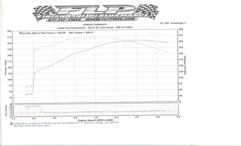

Well, just got dyno tuned by a very reputable shop here in Illinois..... Finish Line Performance. Very nice folks by the way.
The car only made 256hp and 268 tq
It was tuned on a dynojet dyno
2000gt auto, 65k

Thought the car was should have making 290 plus? what gives, my car have some sort of problem or something. The guys at the shop told me the numbers I made weren't bad at all.
Stock gears, changing to 3.90's soon.
Will scan and post the dyno sheet tomorrow
even still.....I don't have a baseline before modding but I'm what.....215hp stock give or take? All those mods and 40hp? I have done any seaches but I could swear I've seen comp set ups on here with considerable more horse that I have. I did ask him if I did something wrong with installing all the parts or something and he said no. Car runs great numbers are not bad and actually quite good.:shrug:

What kind of Dyno-Jet? Were the runs done in Inertia Mode or Load bearing mode? Which correction factor if any was used? And the list goes on...

Your dyno sheet is SAE corrected. It kind of matters what Dyno-Jet they have. If it was in load bearing mode, it will read very close to what a Mustang Dyno will and the numbers will be lower...
The graph is small and hard to read. it looks like it says 53.7 F 30.05 in-hg humidity 22% SAE: 0.9x I can not read the last number. where was this done that in Sept. the temperature was this low?
Can probably read this a little better.

He did tell me that my injectors were maxed out. However he did say that there was not a need to upgrade unless more mods were done.

I will call and ask him a few questions before he leaves tonight. Can you guys help me with what to ask.
1. What type of Dynojet was it?
2. Was it in load bearing mode?
3. Are you sure the injectors weren't holding me back?
Anything else to add? I will wait to see if any of you guys have suggestions and call in about 2 1/2 hours or so and post what he says.
