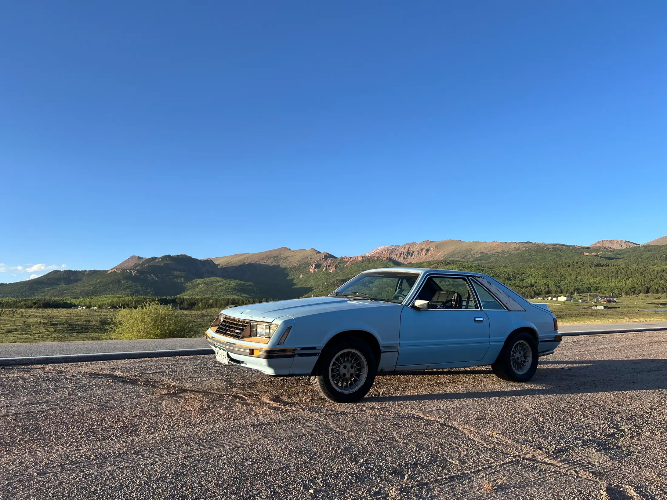

Alright everyone, I’m new to the foxbody scene and I’m dealing with an oscillating front end shimmy at 50+ mph. I’ve replaced inner/outer tie rods, sway bar end links, shocks, wheels and tires, fresh alignment and balance. I’m thinking it’s got to be in the steering components further up but let me know what y’all think could be the issue. (It’s also been on a lift and doesn’t have any play in the bearings.)
