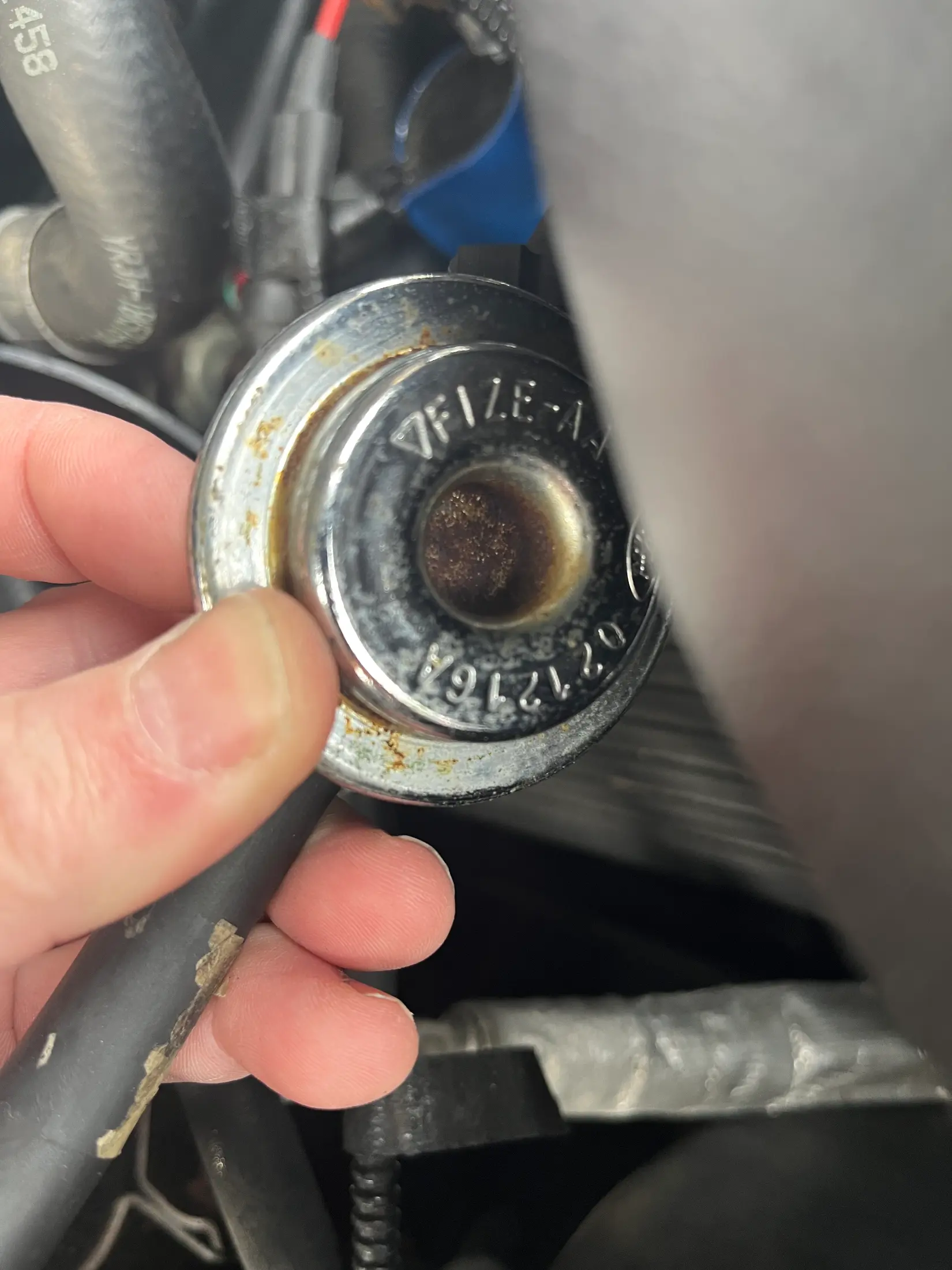

Anyone know where I may find a replacement fuel damper for my 2003 Mustang GT? My car sat for 15 years before I bought it and ethanol evidently trashed the fuel system. Replaced tank, pump, etc. and have it running well, but I blow fuel injector o-rings upon crank sometimes due to a fuel pressure spike on cranking. I’m wondering if the fuel damper is gummed up and needs to be replaced, but I cannot find one and Ford discontinued the item (along with so many other parts!).
