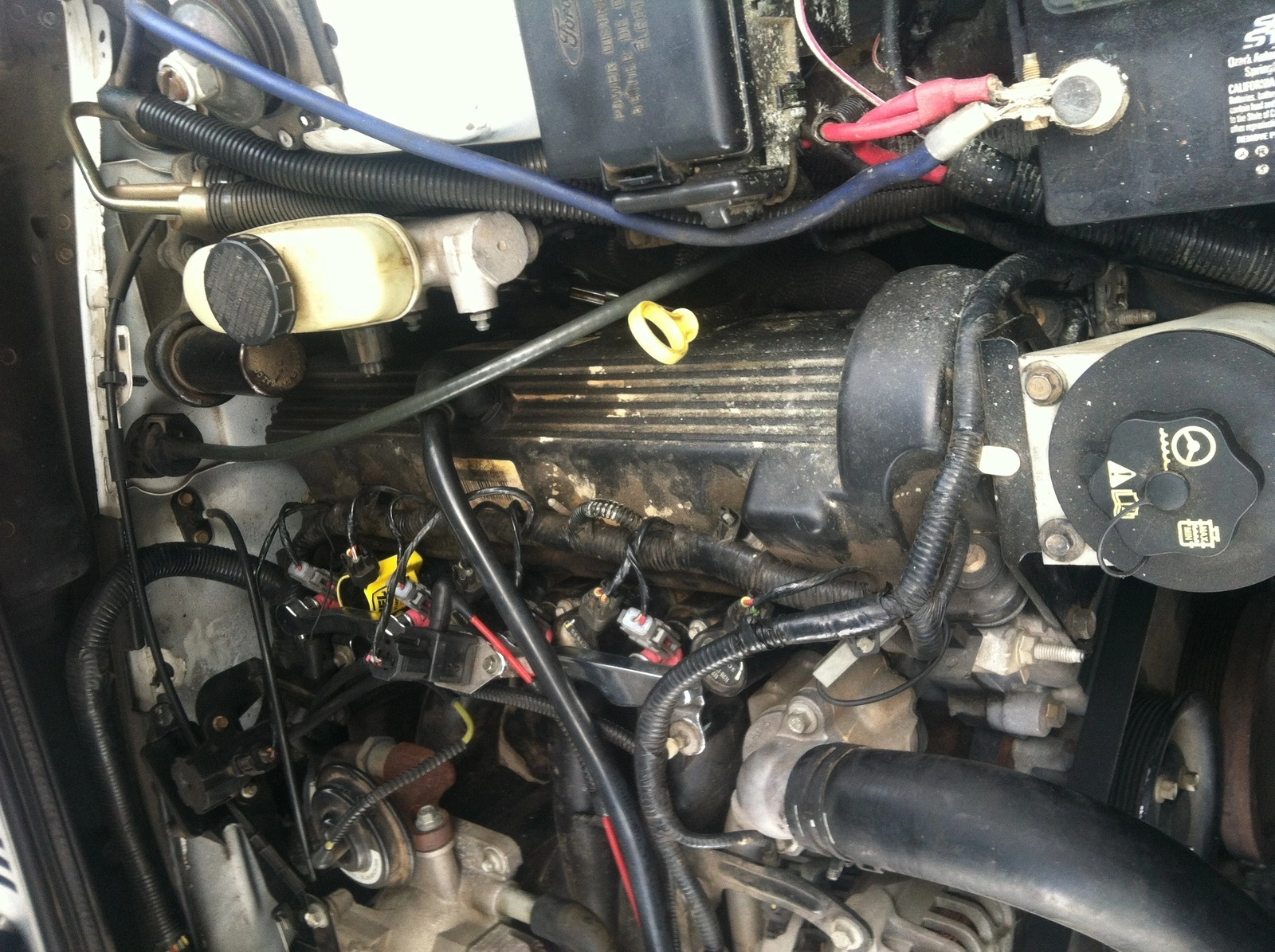

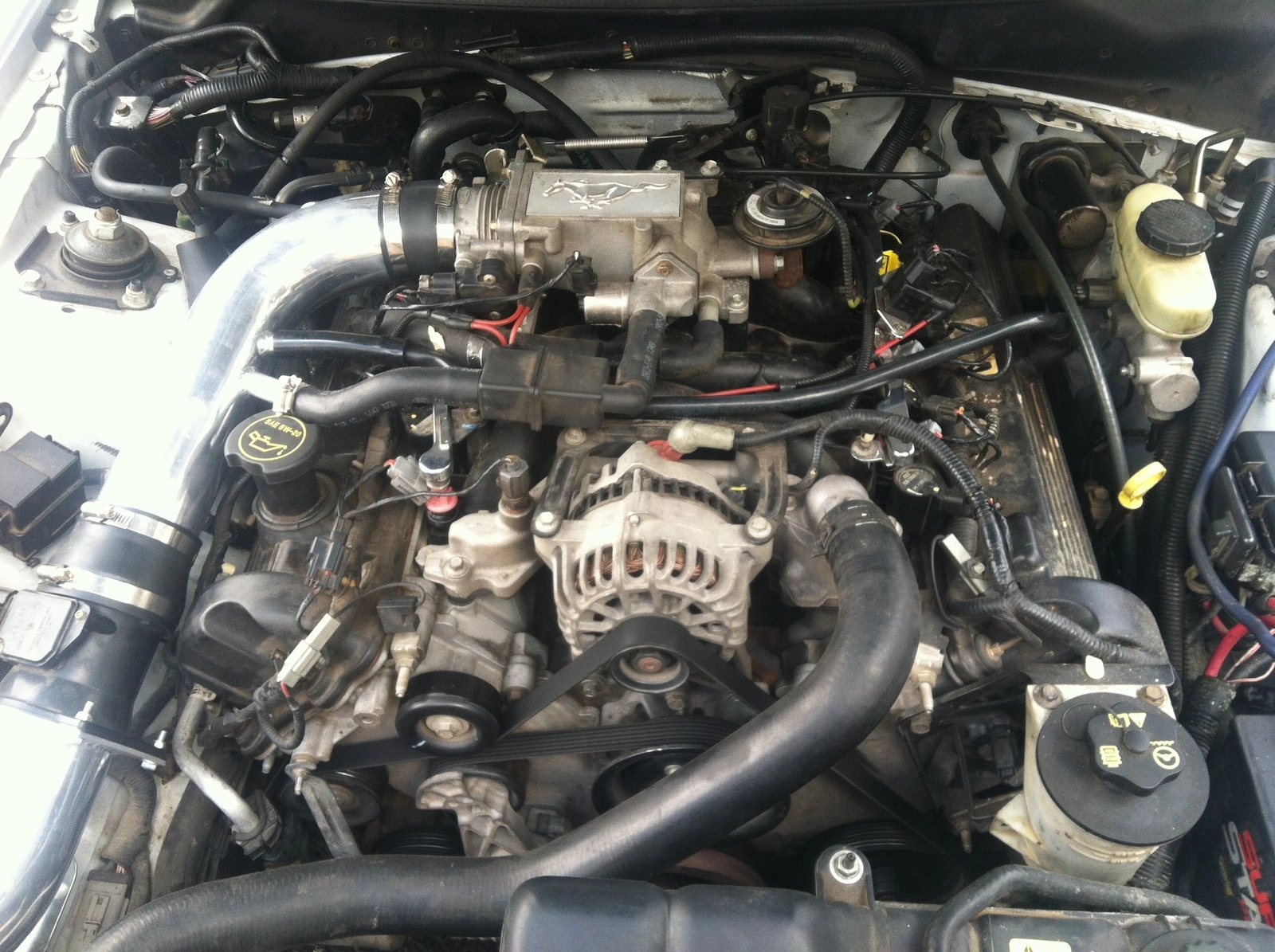

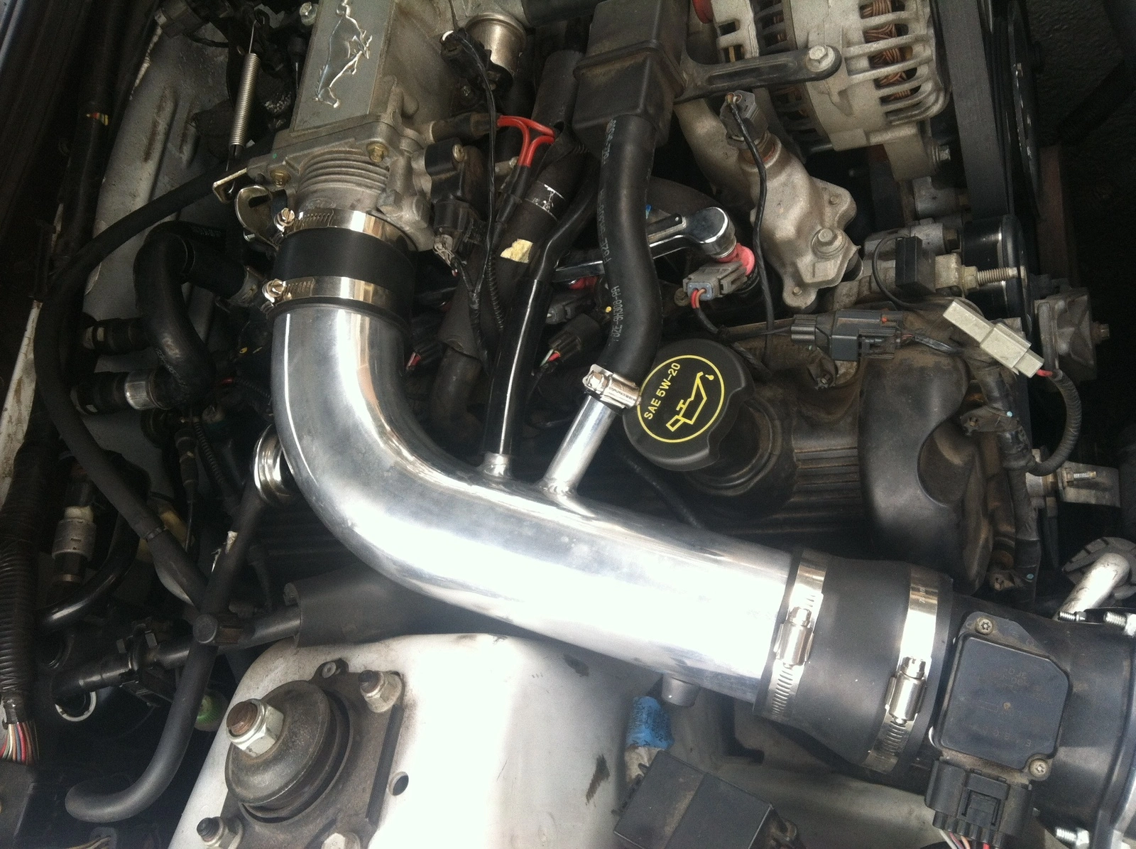

O2 sensors normally don't give driveability issues. They may affect your fuel mileage but the the backfire is more than o2. Whatever other problem you have could be affecting the sensors. Normally you wouldn't get bad sensors on both side at the same time. Clean the MAF first. That is cheap.
Can you take pictures of each section of your engine? Top view is fine just to make sure everything is where it is supposed to be. One from the rightside, front right, center, front left and left.

After driving the car around the MAF didn't seem to be the problem I still have the backfire and a little hesitation.
Here are the pictures you asked for.

Here is another. For some odd reason it's making me post them separate

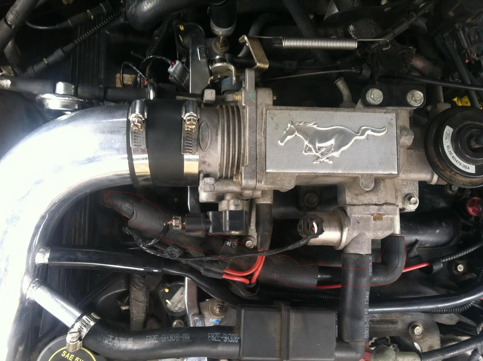

Look closely at this hose here. Make sure it has no breaks under the insulation. I have it outlined in red with MS Paint

Okay I check it in the morning since it is too late right now.
Thanks for the help so far C0ramprat.
I'll get back to you as soon as I check it.
