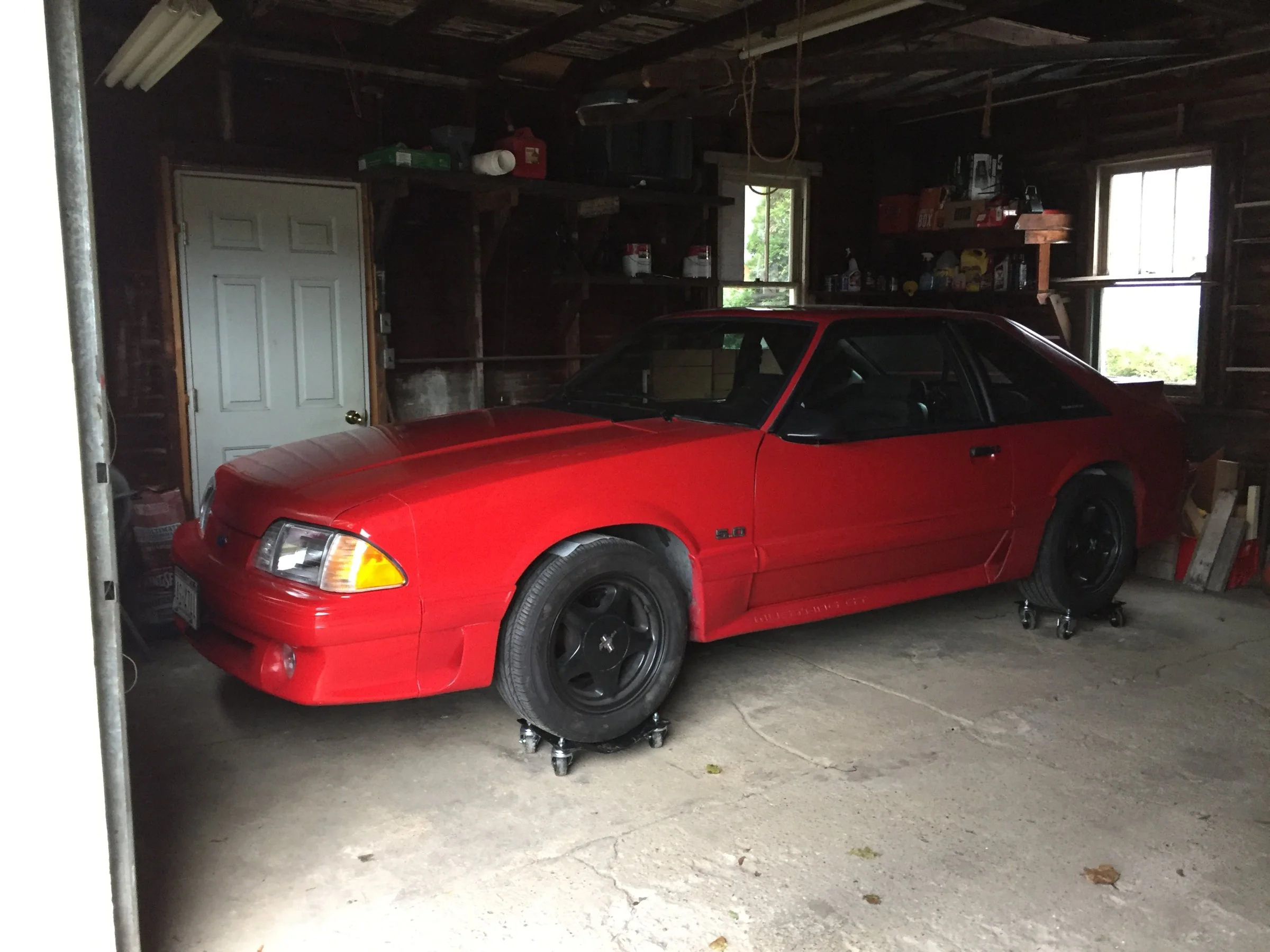

It's getting cold here in south eastern Wisconsin so this last weekend I decided to put the car into storage.
Did all the usual stuff, cleaned it out, changed the oil, checked and topped off the coolant, filled the gas tank and added Sta-bil. Then I put the car on dollys and (with a great deal of pushing and swearing) I pushed the thing into the side of my garage.
This proved to be a fools errand because the next day when I went into my garage it REAKED of gas. I checked under the car and the gas tank was damp with gas. Didn't see any specific place that was leaking from, Fuel lines and filter look good, but I do have a couple questions to help me figure this out.
1. I filled the tank including a slight top-off (which normally I don't do) is it possible I just overfilled it? If so, what are some common spots these cars leak from? Do they have some kind of a fluid vent that perhaps it's just leaking out of?
2. The car has an aftermarket fuel pump. (225 lph) and a metal gas tank(I thought the original was plastic). The work order I have from the previous owner says that the pump, tank, and associated gaskets where replaced at some shop in Michigan where I bought it. If I need to check any of that work, other than dropping the tank, is there anyway to access the pump and any of those gaskets?
I've only owned the car for a couple months and have only driven it on nice days and whatnot so I've never filled the tank before. It's had up to 3/4 of a tank full with no problems. My exhaust is dumped well away from the rear end so I am wondering if I should just run the car for a while and try to burn up some fuel. Cold temps and snow are not to far away so I'd hate to pull the thing out of storage considering I just put the dang thing in there.

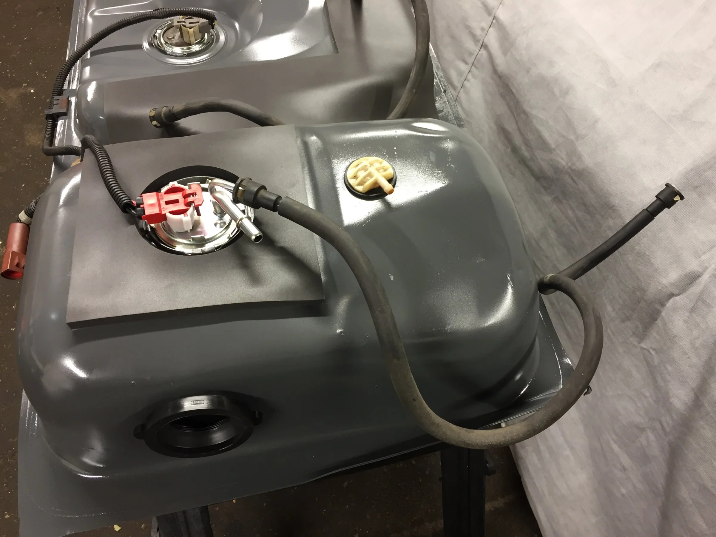

Crawl under the pass rear side of the tank area. You'll see the filler neck and its seal and should be able to tell if it's leaking.
The tank vent is in very top..hard to leak gas from there
Here's pass side of tank. You can see filler neck seal, and the small vent on top

Had the car on a lift today (my buddies shop) and fuel is coming down from the top of the tank. Not really concentrated on one side or the other.
The thing I keep coming back to, is that I've had ZERO smells or drips until I filled the tank up.
O ring for pump is usually high enough to not have to worry. I would suspect fuel sender o ring, or a puncture?
Your suggestion about a puncture is interesting tho, because it is a new-er gas tank and if it has a bad seem that could cause it to leak only after I filled it to a certain point.
Today, I did have a smoke pressure test done with the system still in the car, and it wasn't enough to produce a leak unfortunately. The next step would be to drop the tank (as you mentioned earlier) which I'm not against, it's just getting cold, and again, I'm trying to put it in storage.

You really only have 4 potential leak places before you must suspect the tank.
Filler neck seal is easy to see and rule out.
Vent and fuel punp seal are highest part of tank and hard to leak unless the seals are really blown.
Fuel level sensor could be under the full level if you really top off the tank as the pass side bulge for the filler is higher than rest of tank. If one of the 4 were to leak and not be the filler neck seal, this would be my second guess.
I'd siphon the tank down a bit and wait for spring...unless you just want to address it during the off season. But either way tank needs to drop
