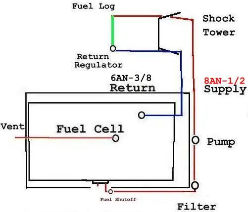

393Bird Founding Member Jun 26, 2002 244 0 0 Clarksville Tennessee Feb 28, 2004 #3 Feb 28, 2004 #3 Here is my setup for street/strip use. Full details here: http://www.qsl.net/wd4ngb/birdwork5.htm Attachments fueltank.webp 13 KB · Views: 192
