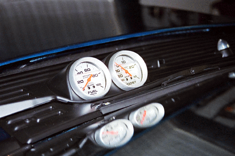

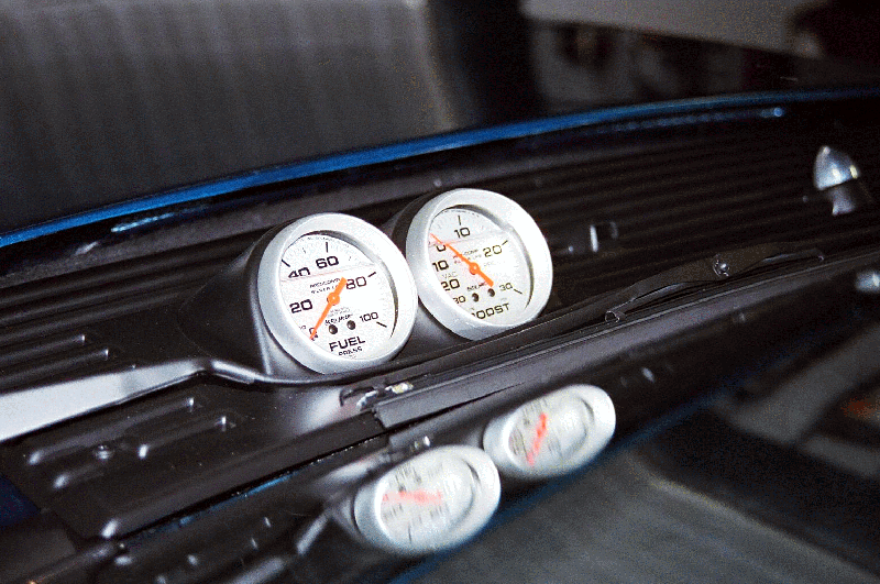

You can buy the Autometer Stainless Steel braided hose for like $60. Or a local shop that makes hydraulic hose assemblies can make it for you at a cheaper price. Ordinary low pressure hydraulic hose can be used in place of the Stainless Steel braided hose, the Stainless Steel braided hose just looks nice. I got mine for $4 at a place that sells industrial and military surplus parts of all kinds. The Stainless Steel braided hose goes for about $3.60 a foot and the fittings are probably about $5-$8 each. You can make your own and save some $$$, the shops may have a setup or labor charge to fabricate the hose assembly.
So for the mechanical gauge I have I should use the 17945NOS part, correct, which goes from the shrader valve location, correct?, which connects to the braided line, which then connects to the gauge, am I right?

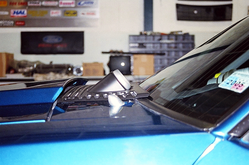

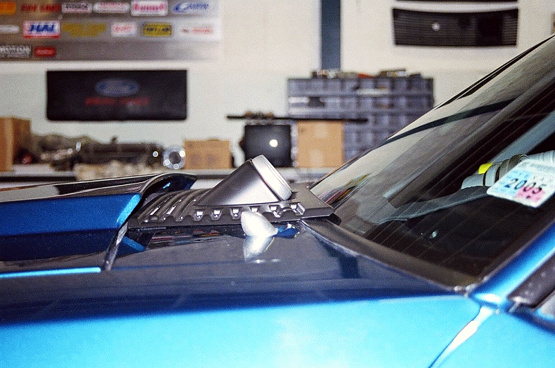

I'm still up in the air on how I want to do it. i like the cgc one, but am still looking for other options. Where did you get your pods, Mustang5L5 or TMOSS?
I also saw a write-up on it somewhere on how to do it, but I can't remember where, in which they just had a pod that kind of strapped onto the cowl area or attached somehow to it.
