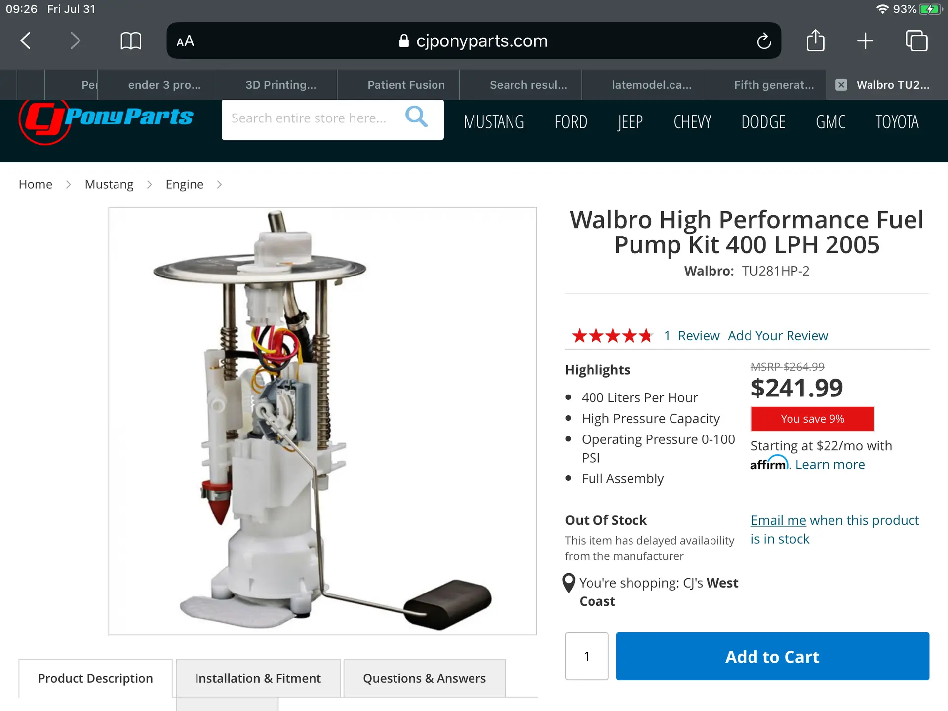

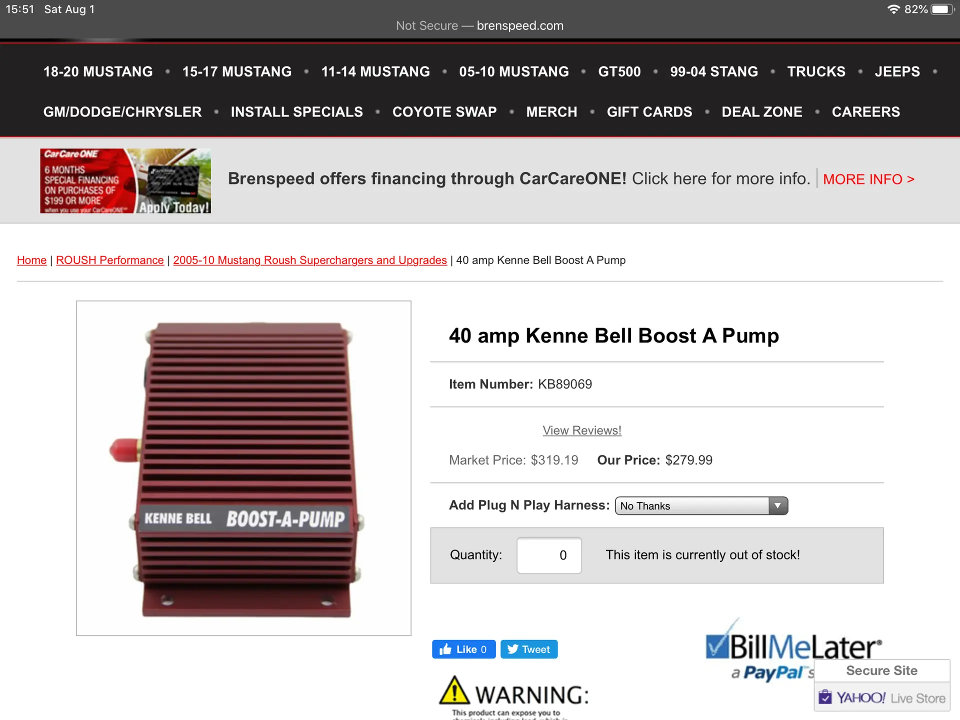

Not sure if this helps, but I’m running a boost-a-pump on my stock fuel pump. I have a 05 GT with an Edelbrock Supercharger and am just under 600 hp. Haven’t had any issues. I just recently seen this fuel pump too. Found it in the cjpony.com website.
