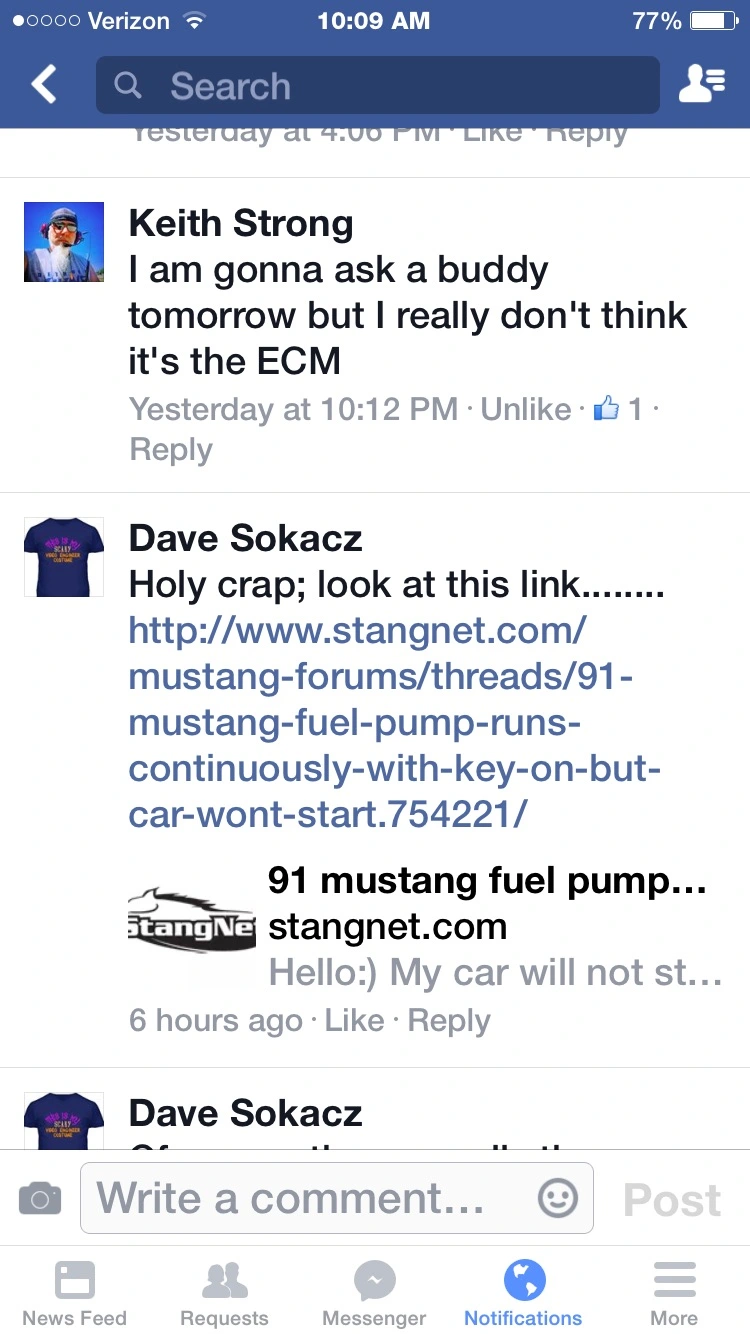

Hey guys... I can't get My 91 ragtop
To run. Here's a copy of the thread I was following ; identical symptoms, and the guy sold the car without a final fix being posted.
Any ideas would be greatly appreciated
