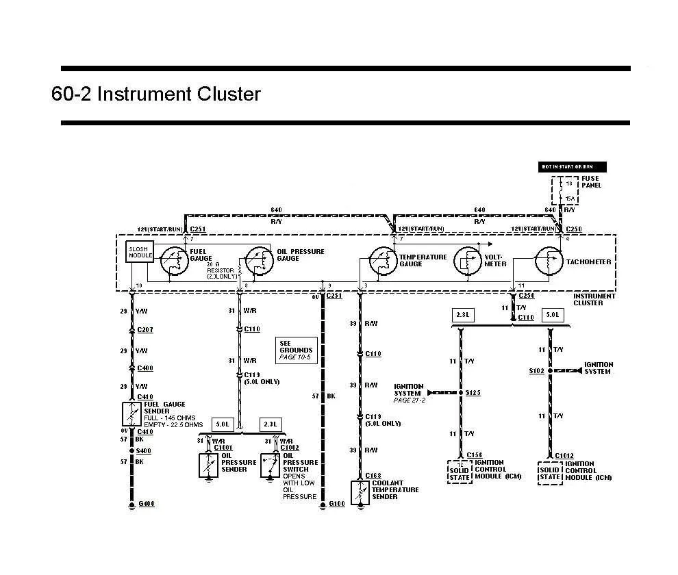

Ever since i did the engine swap and redid all the wiring in the car my fuel gauge hasn't worked. It worked before all of wiring i did. I am carbed now and i pulled out all of the computer wiring. I was wondering does the fuel sender wire directly into the dash gauge or does it run through the computer? Thanks

Fuel sender is connected directly to the gauge via the slosh module.
Slosh Module?
How can I pin point my problem?

The slosh module is the little circuit card plugged into the back of the instrument cluster.
Other areas to check:
Connectors
C207 - behind LH cowl panel
C400 - below rear of car above fuel tank
C410 - at sender
Splices
S400 - rear lamp harness somewhere around where G400 (below) comes out of the main harness.
Grounds
G400 - center rear of cargo area
