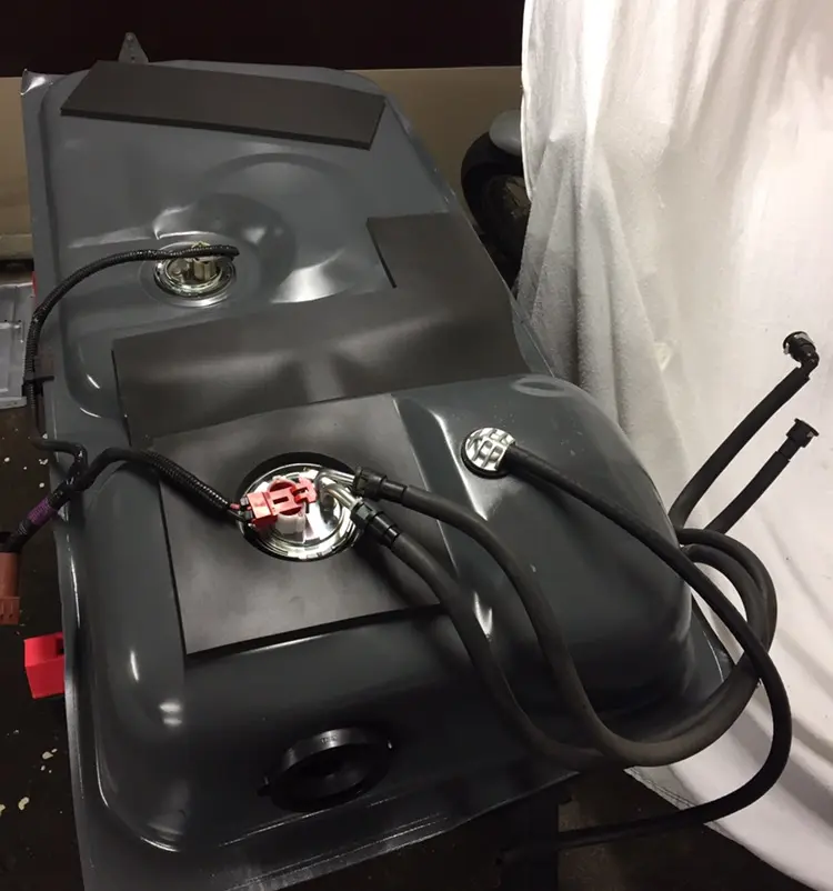

It is on the top of the tank:
All I did was replace the rubber bushing between the filler neck and the gas tank because it was leaking fuel. Didn’t drop the tank. Filler neck was pulled out, grommet replaced and then reassembled and now it kicks of the gas pump as if it’s full
It's not, the only vent is on the tank. There is a piece of metal attached inside the filler tube at the bottom so someone can't siphon (only reason I can think of) gas out, unless you smashed it somehow or got something jammed in there restricting flow.
I think you could pressurize the tank with a couple pounds of air to see if the vent is plugged or pinched but I honestly feel if the problem didn't exist before the grommet replacement something would be amiss with the filler neck install.
The fill pipe pulled out of the tank pretty easy, would it have been something attached to the end that’s now in the tank? The end of the fill pipe was just a straight end nothing on it . You could feel in the end and the pipe is divided into 2 tubes, I could feel that. But nothing specific on the end just straight pipe.
I've done the seal on my 93 and I can't figure out what the he'll you could have possibly done to F it up.You can try taking the filler neck loose and reposition it ??? Guess that's worth a try.
Yea I agree bud , it’s kinda crazy, pretty positive the pipes not damaged. got about 5 bucks worth of gas in it fighting it every drop. Everything lined back up in the fuel tank door to bolt it back together Only thing I can figure is it’s a little too far in or twisted just slightly. Really doesn’t make much sense.
