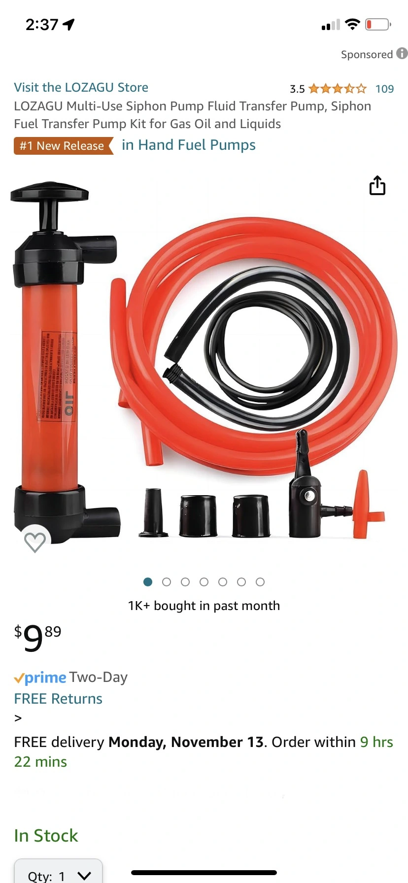

And if not mechanically inclined then an old hand pump may work as well with a long enough hose.
Amazon and harbor freight has them for 10 bucks.
