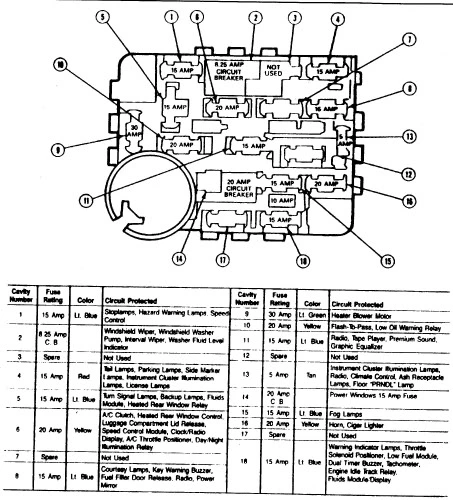

D Doc90 New Member Apr 18, 2006 38 0 0 texas Apr 29, 2006 #1 Apr 29, 2006 #1 does anyone have a diagram of what each fuse does in the fuse box i dont have a cover or a manual and it is not listed on box itself. any info would help 90 notch

bill302 Active Member Nov 2, 2005 2,131 1 46 alabama,gadsden Apr 29, 2006 #3 Apr 29, 2006 #3 here you go.. Attachments 89-93fuseboxdiagram.webp 65.6 KB · Views: 154
