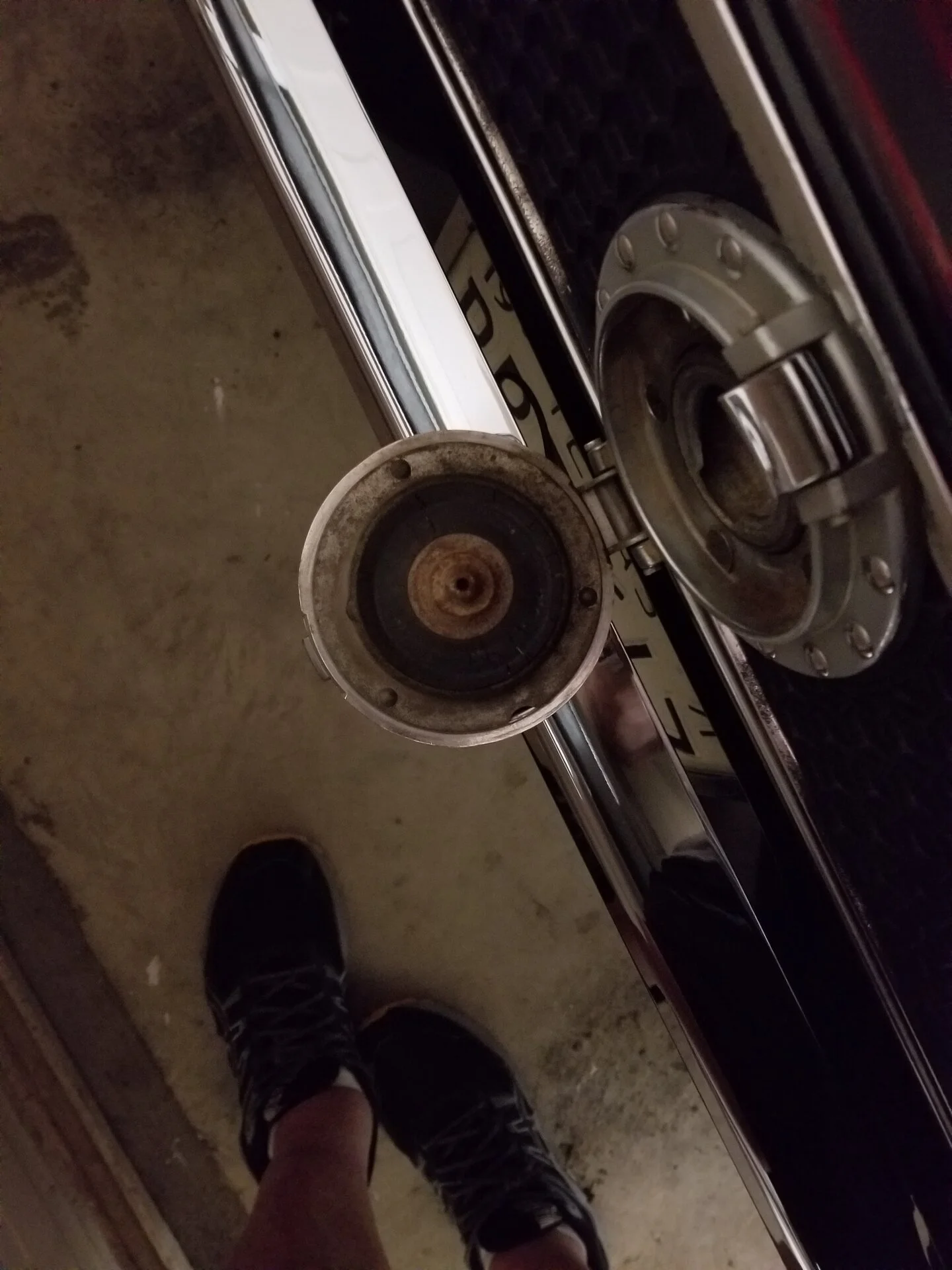

I have looked on line but haven’t found a gas cap replacement for my 71 Mach 1.
It is the flip open type attached pics.
Any ideas?

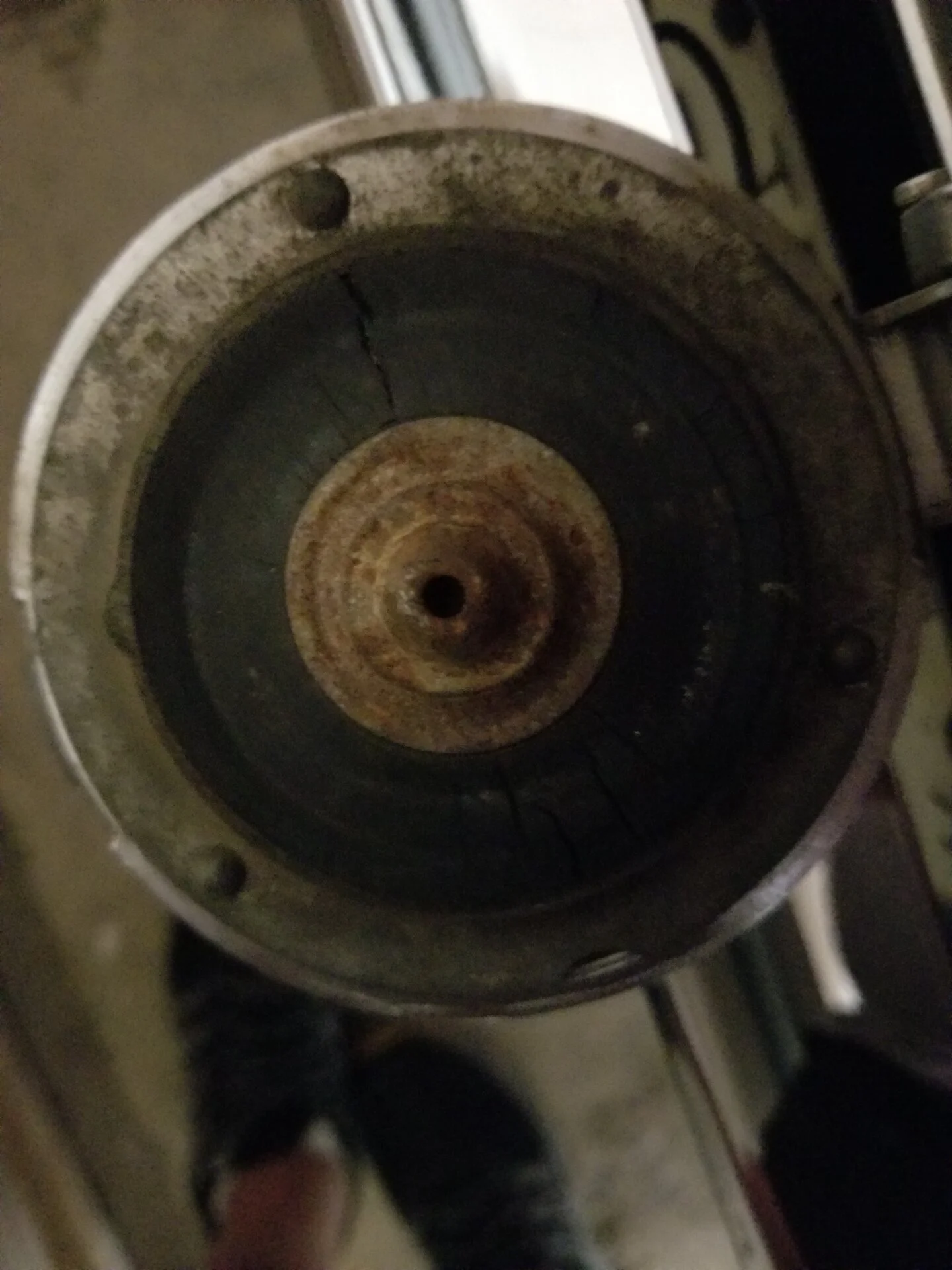

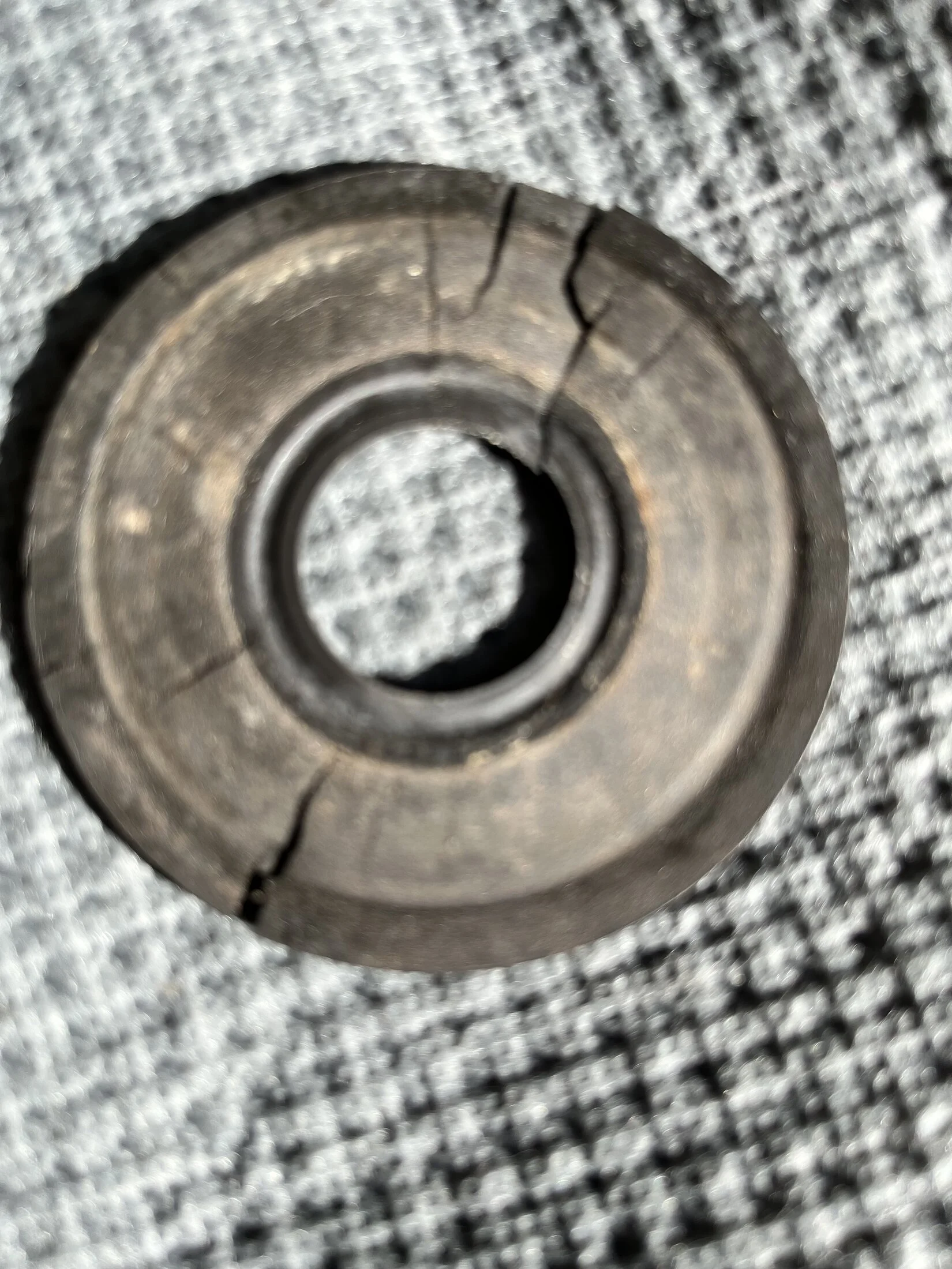

I have posted similar post regarding gasket replacement.
The gasket on my 1971 Mach1 pop open gas cap is cracked and flattened. Believe it is the original.
I have finally decided as suggested in previous post to buy a piece of Nitrite rubber or cork and try and make my own.
What is the thickness I should buy? Can’t measure the gasket on the cap and if I try to take off it will break up.

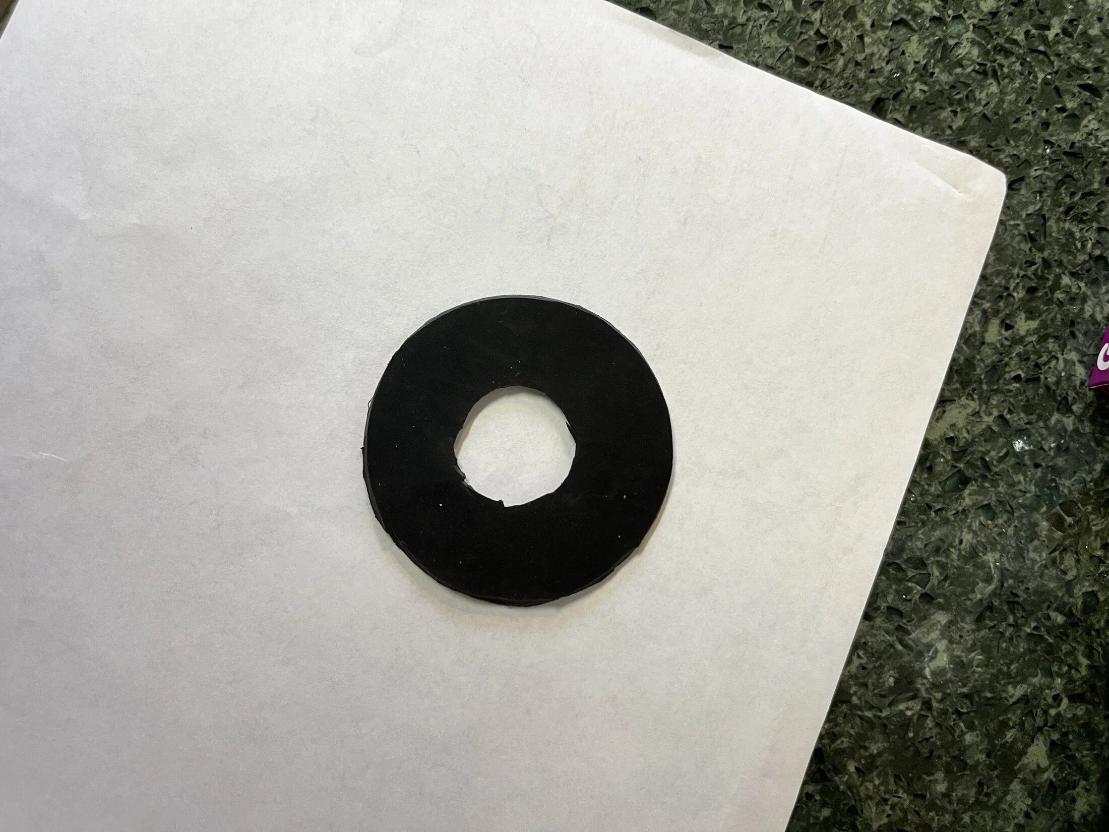

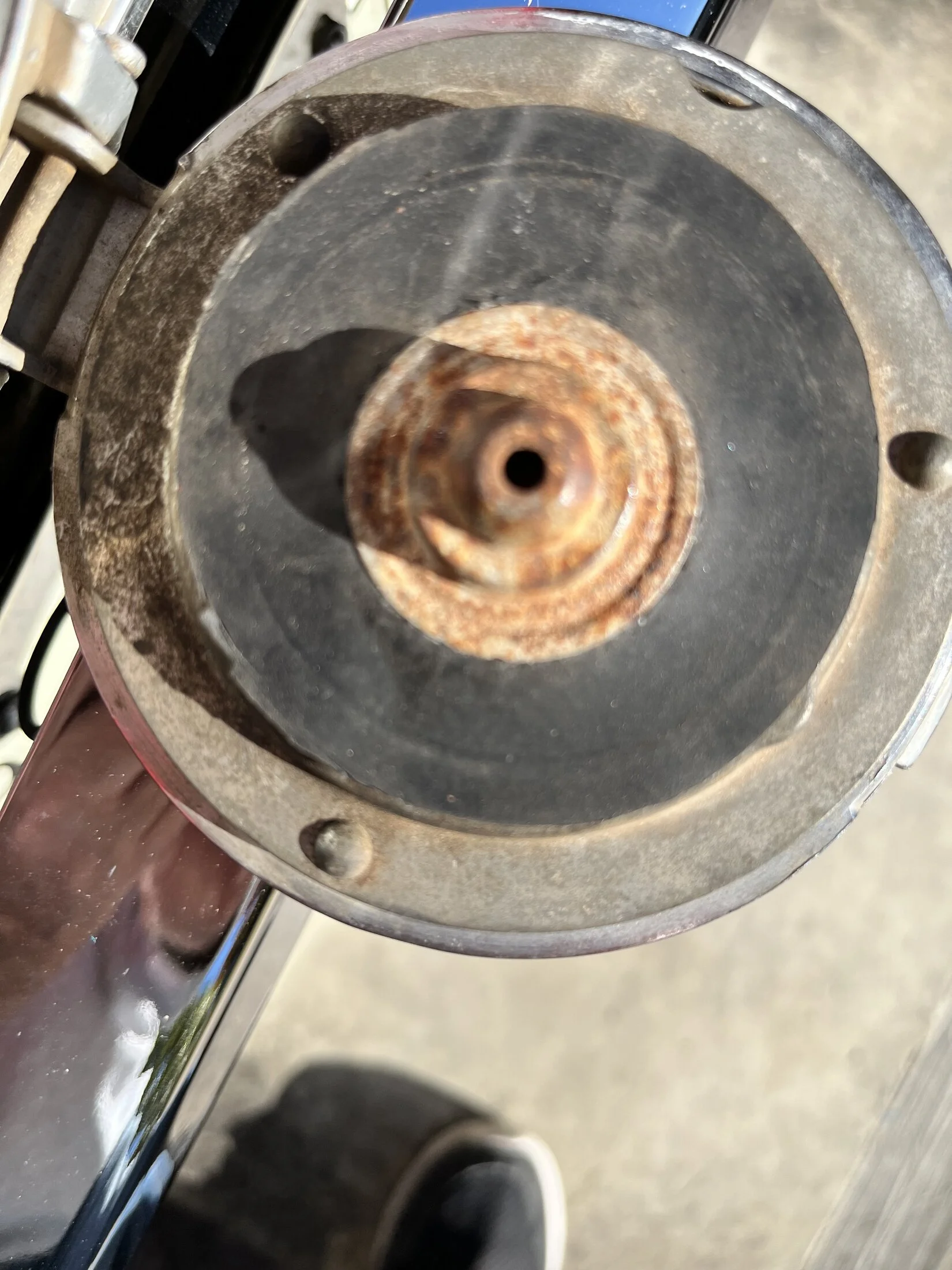

I decided to make my own. I found 3/32” thick neoprene 12” x 12” sheet on Amazon for less than $5. My existing gasket measured 3/32” using a multimeter. Found that the diameter of a can of soup is just slightly larger than 2.5”. I marked it on the sheet of rubber and cut it using a exacto knife. Then found a socket that was an inch diameter used it for measuring and cutting the center hole. Not perfect but it seals very well. I stretched the rubber around the center and with a thin flathead screwdriver push under the lip.
I have attached a few pictures and below is the link to Amazon.
