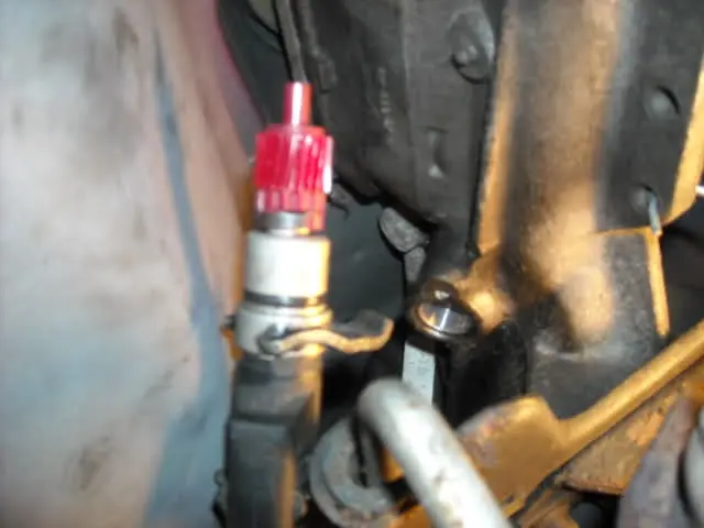

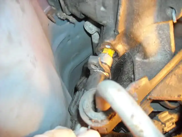

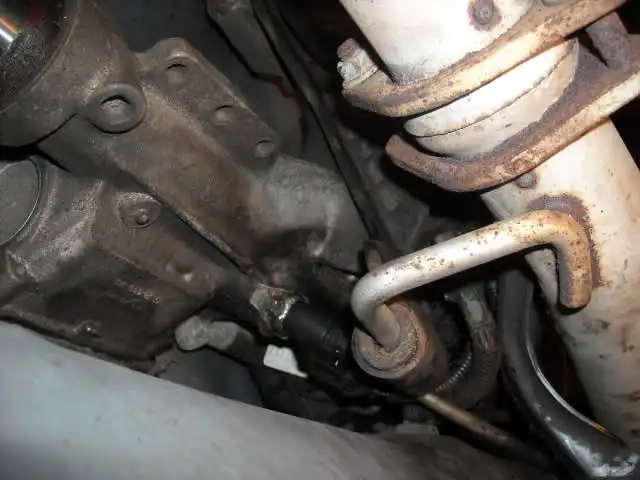

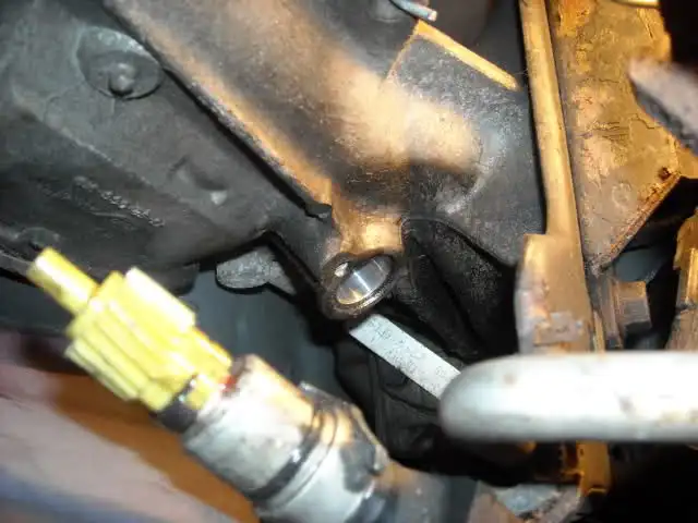

I just did mine.....its easy
INstalled
Its on the drivers side ull see it...

thanks man, pics make everything easier, deffinitely something i can do on my own.
