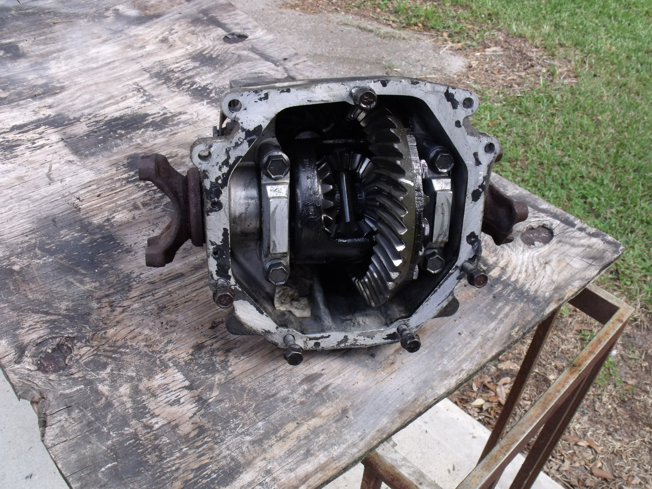

Is anyone running 3:08 gears with a manual trans?? I have a really nice diff with 3:08 gears I would really like to clean up and install in my " not the mustang" using a TKX with a 2:89 first gear.... When I was young 3:08's sucked, but the muncies had either 220 or 245 first gears in them....
I know I could get the 3:27 first gear TKX which is probably designed for tall butt gears, but that is not going to happen... I understand this would not be a premium gear for any type of racing but the car will not be tracked or drag raced.. And I do NOT want to have to slip the clutch a bit too much everytime I start the car from and stand still.... I just don't want to hate these gears and have to redo them ( although its not too hard a job removing the Dana 44 from my C4 suspension) ....
Is my 50 year old memory correct or can any of you tell my your 308's are OK??
