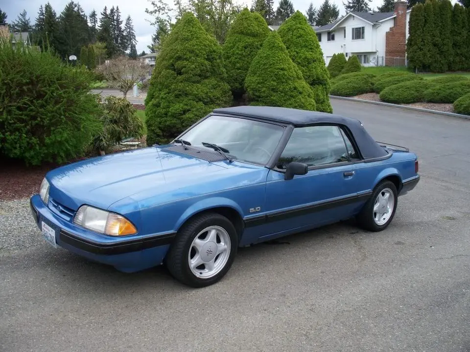

Hi guys I am looking for some input and suggestions for my 89 lx 5.0 with automatic. Currently pretty much stock.Car has 82,000 original miles. I want to find what gears for the rear I am not driving this daily and will rarely see the freeway with her! I want her to get up and jump. I am looking at 4:10's or 4:30's???? I am planning to replace the trunk lid with smooth one and limited edition spoiler. Currently trying to work my way through all the bushings in the front and replace it all. I am not a big gear head so any and all help is appriciated. Thanks Brian

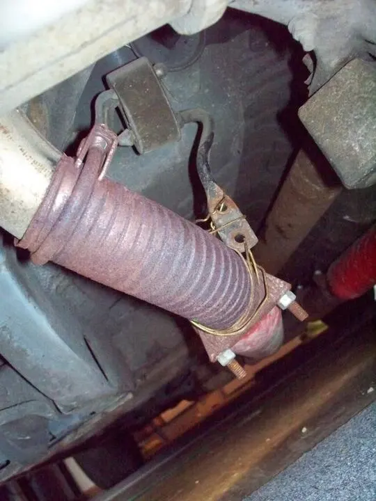

Tore down the front end last weekend to find what was popping when I stomp on it. Found a lower A-Arm that had been road rashed like it was drug on the ground for several hundred yards. The ball joint was loose and I could move the entire assymbly up and down just touching it. Like I said before the previuos owner was a tweeker look at this pic of the exhaust when I bought it Now it has Flow master 44's and brand new exhaust all the way through. Got new Brakes, Bushings, Rotors, etc.. to slap on when I get the A-Arm.

That isn't a tweeker, that's a hack. I would recommend Maximum Motorsports full length sub frame connectors. I put regulars on my hatch, and full lengths on my Cobra. Now I wish I had put the full lengths on my hatch too.
