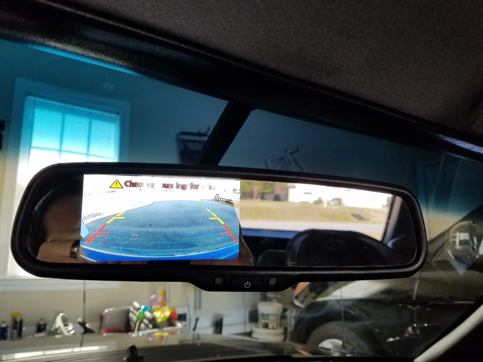

Here's the one I have:
Amazon product ASIN B01KDT4WHYView: https://www.amazon.com/Master-Tailgaters-Adjusting-Brightness-Temperature/dp/B01KDT4WHY
I also have a backup camera that will fit perfectly in my hatch.

Camera with LCD screen is a nice idea. Would actually be useful backing out of garage with kids around.

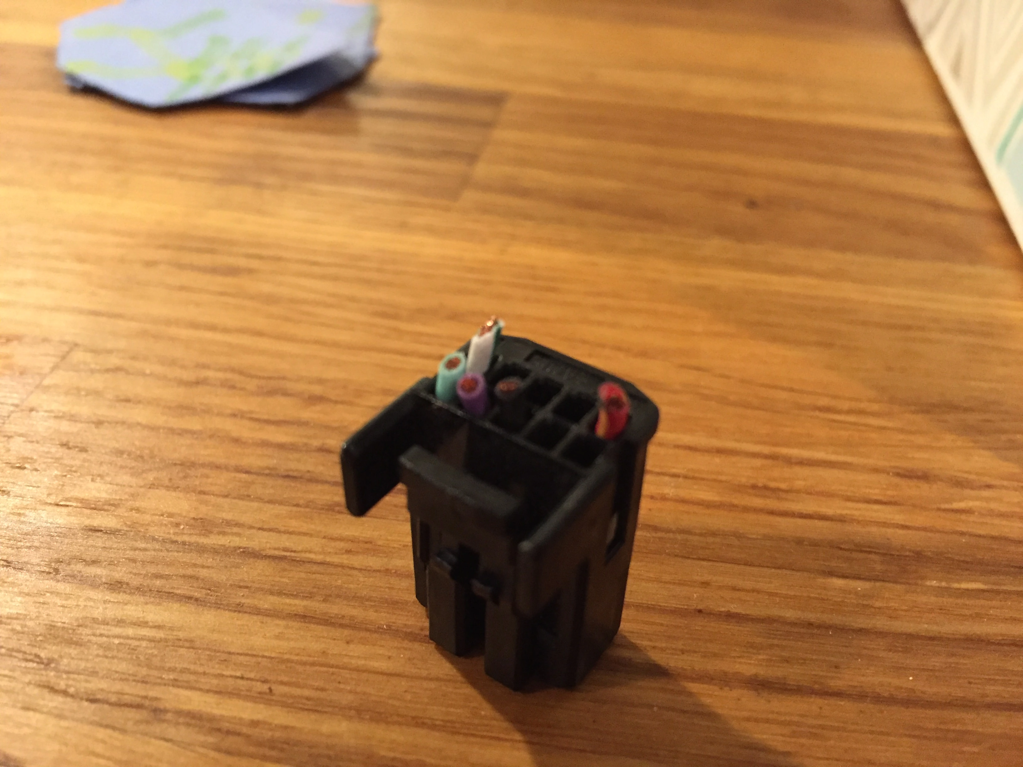

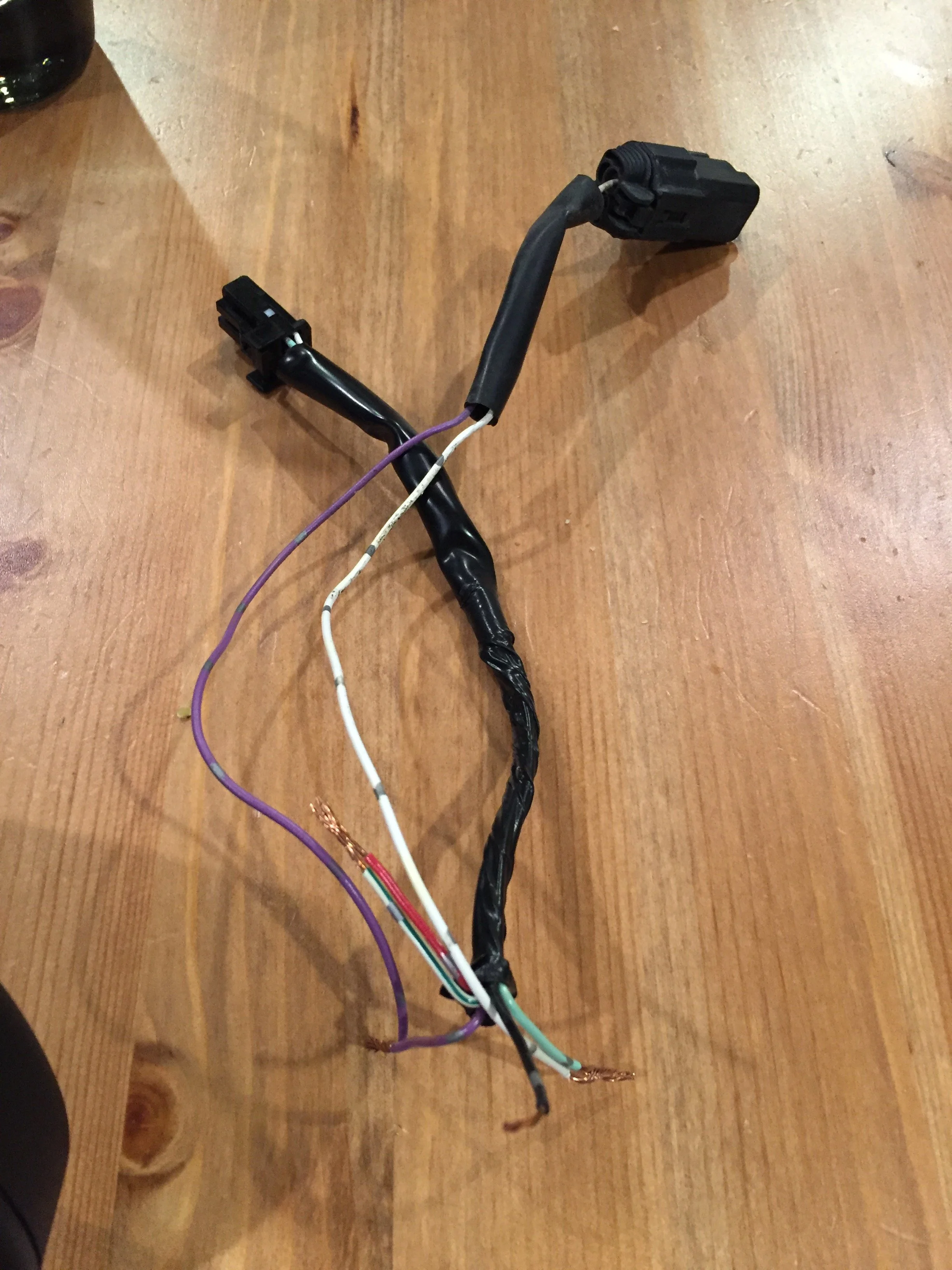

Got my mirror with both temp and compass and homelink. Of course they cut the wiring too short to even splice to. Need a harness but got a temp sensor coming as well
But seriously?
But seriously?
Not hard to repin, right?

We shall see. I bought a harness for the other mirror. May have to swap a pin and add two more using this connector. I'll give it a shot otherwise I'll just go to boneyard and cut a few harnesses off (and take mirrors for eBay sale)

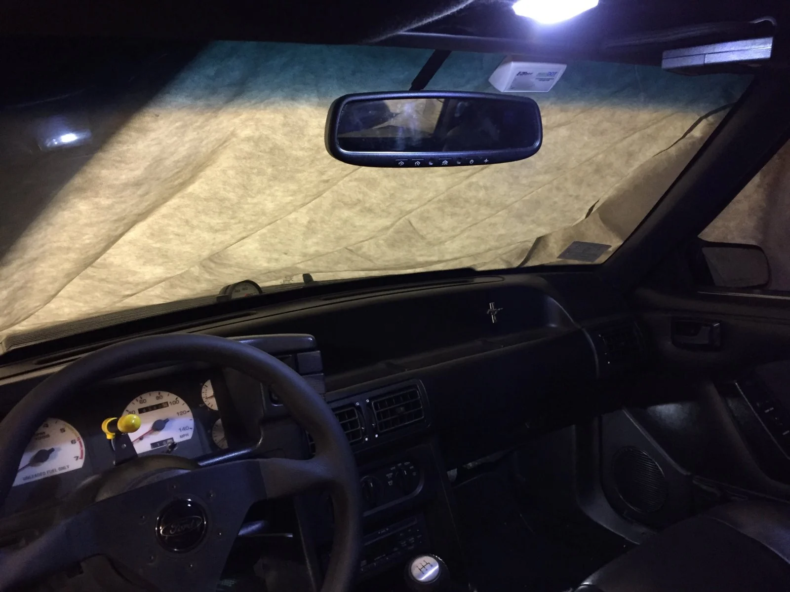

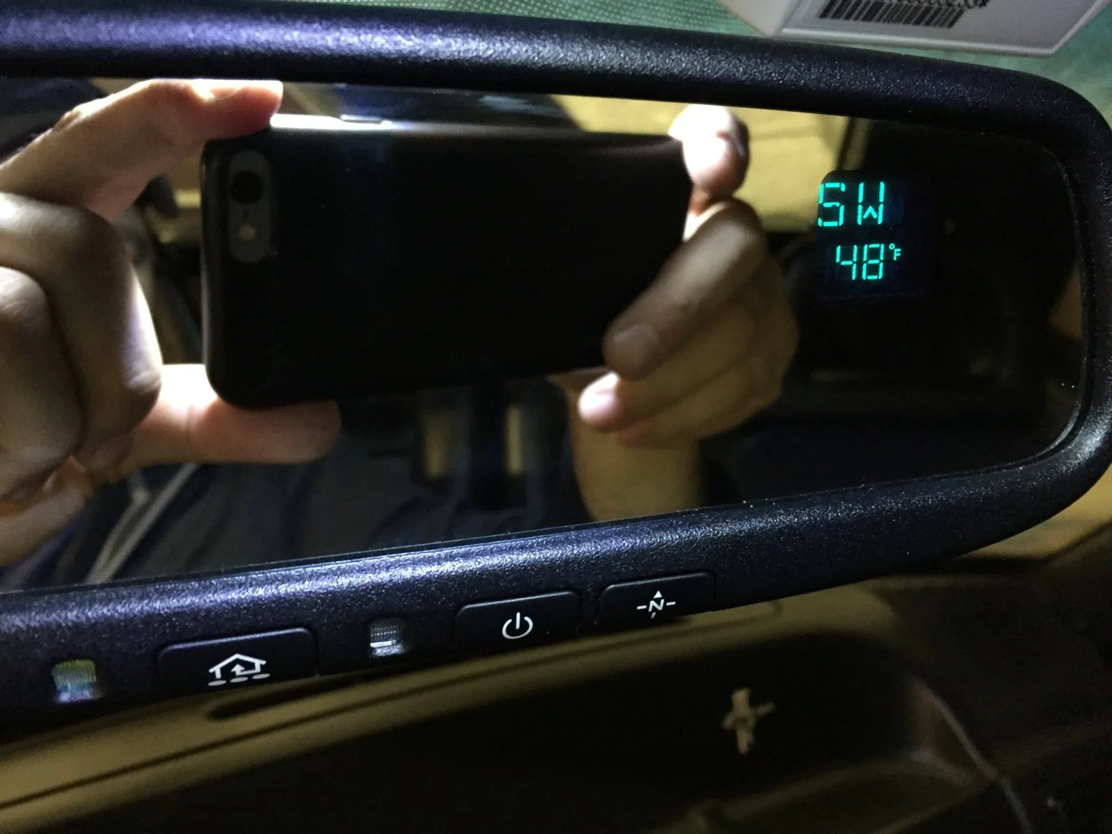

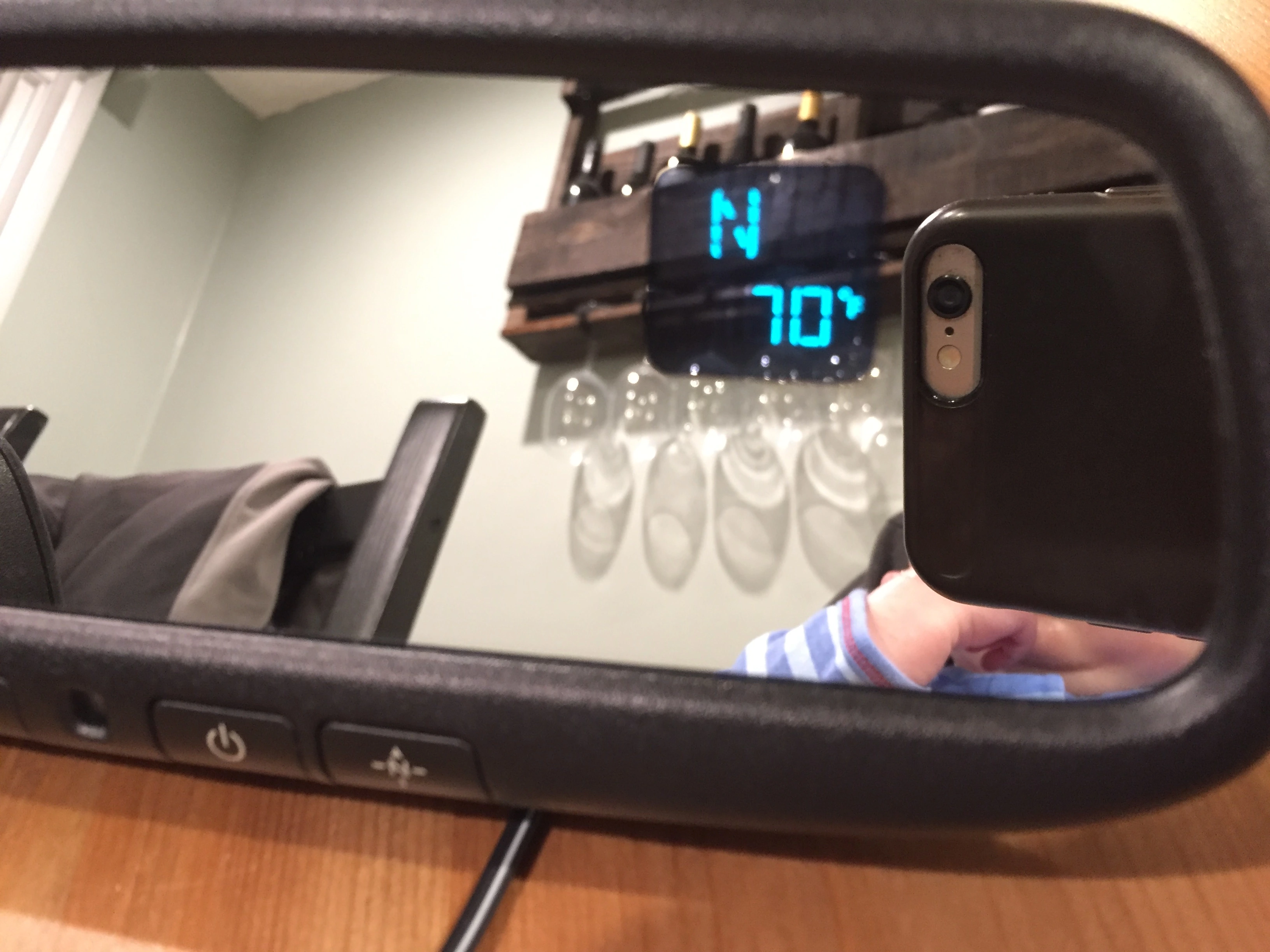

Ok. Got all my parts.
2006 Nissan Pathfinder, of Infiniti QX56 mirror (looks the same as first post). I actually got two of them.
I also got the wiring harness and temp sensor. With the Nissan mirror, you need a Nissan sensor. The resistance values are unique to it.
Dorman 76864 is the part number for the mirror mount to the windshield
But yeah. Homelink, compass and temp!
Here's the wiring diagram
This weekends project will be extending these wires and routing.

Done

I managed to get mine installed this past week. I've still got to calibrate the compass, but overall I'm happy with the results.

Camera is pretty sweet
