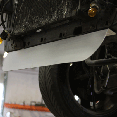

Is the air deflector on the bottom of the radiator support present and in good condition?

You can chase rabbits and throw money at a problem, or listen to reason. The air defector directs the air up into the radiator at highway speeds and is critical to managing airflow into the radiator. If you think that you are smarter than the engineers who studied the aerodynamics and airflow in wind tunnels, you have rude awaking coming to you.

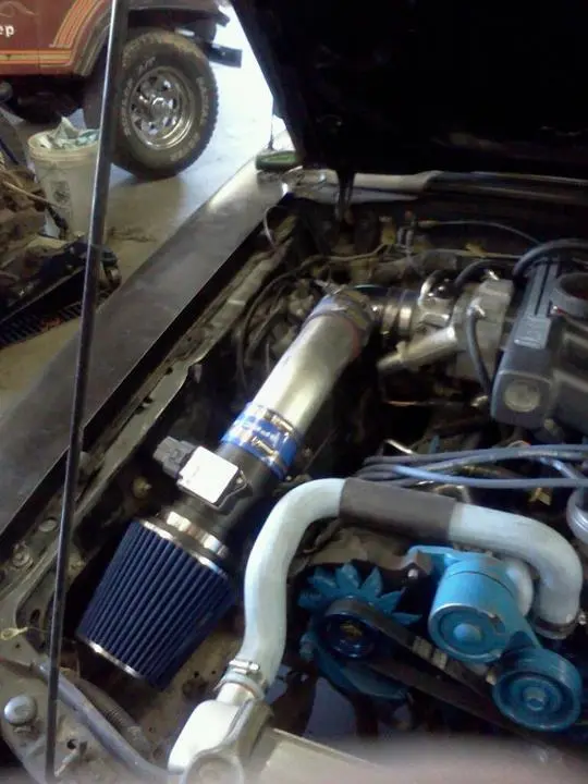

I looked at the picture of the engine in your car, and I already saw one nono - the air filter next to the radiator and fan -a hot air intake.
A cone type filter located inside the engine compartment is almost sure to have surge problems due to the hot, turbulent airflow around it.
Don't do this: it is a big NO NO.

Jrichker is right about the air damn under the radiator but it actually has two jobs, think of it like an inverted spoiler, it allows the air coming through the radiator into the engine compartment to escape under the car also.

The airdam is very important, in fact it has such a large impact that road course racers install oversized airdam on there cars. This creates a negative pressure under the car, this pulls the car down onto the road no giant wing needed.
Case in point. the air deflector used here is from an early ranger/bronco
