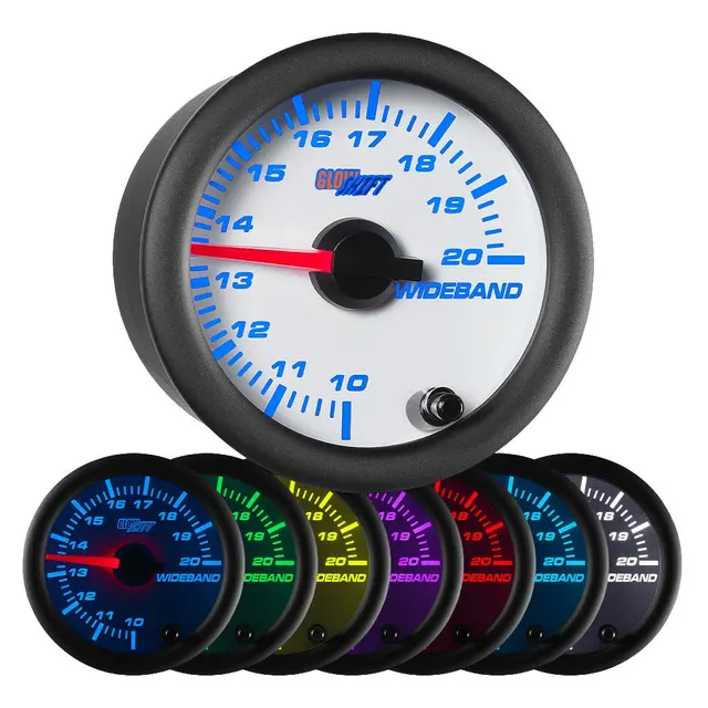

It is [hard] to find a decent analog AFR gauge:
No digital bull for my cockpit, thank you
I might have to give this one a shot and run it off of my LM-1.
Reactions: 90sickfox, General karthief and from6to8
how does it wire in, what are the options? Mechanical or electrical?

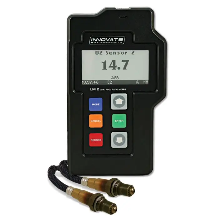

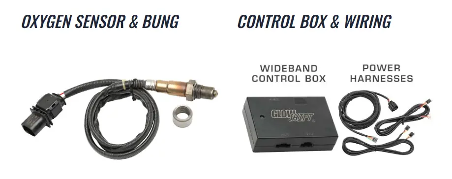

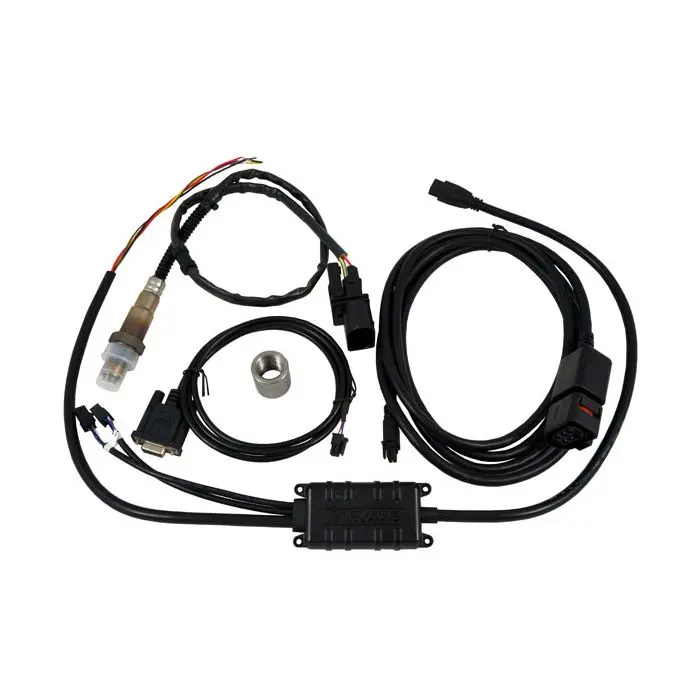

It's electrical and it takes a 5V feed from a wideband sensor/transducer with a 5V output.
Something like:
or
or from the gauge manufacture's own web site:
The gauge itself is essentially useless without a wideband meter with a 5V output.
