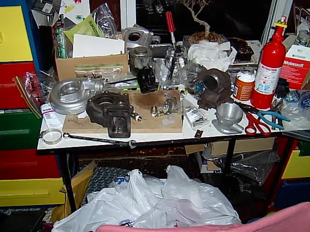

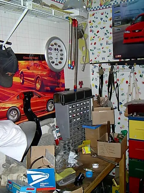

The head is on my dresser right now, with my hand-polished and waiting-to-be-powdercoated valve cover on it. The crank is also on my dresser. I have a box of pistons/rods on the floor, as well as an upper intake, two boxes of mostly junk, and some misc tubing and whatnot. To top it off, my bookshelf has two turbos on it. :D I love my interior decorating style.....although having a small garage sucks. :(

These are pics of my room from where I sit at my computer.
Ash
You still work at sears, right?
The table I have in the first pic is an old display table that I got from the store for $5! It's a really nice, sturdy table too (I had all that crap on it plus my cylinder head until earlier today, took it down the basement). You might be able to find a deal like that if you ask if they have any display tables they're ditching.

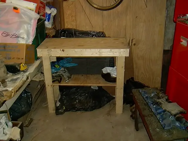

If not, it's pretty easy to build a table out of a few 2x4's and some plywood. This is one I made to work off of in my grandma's garage:
