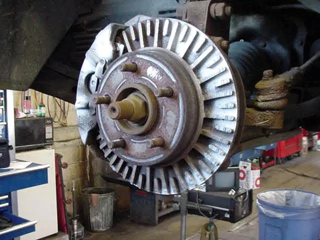

:D my brake rotors are cracked from overtightening... would you consider that angry?:(
Do they look like this? :rlaugh: :rlaugh: :rlaugh: :rlaugh: :rlaugh:
Now back to the topic at hand. What size air line are you using? It makes a difference :nice:
