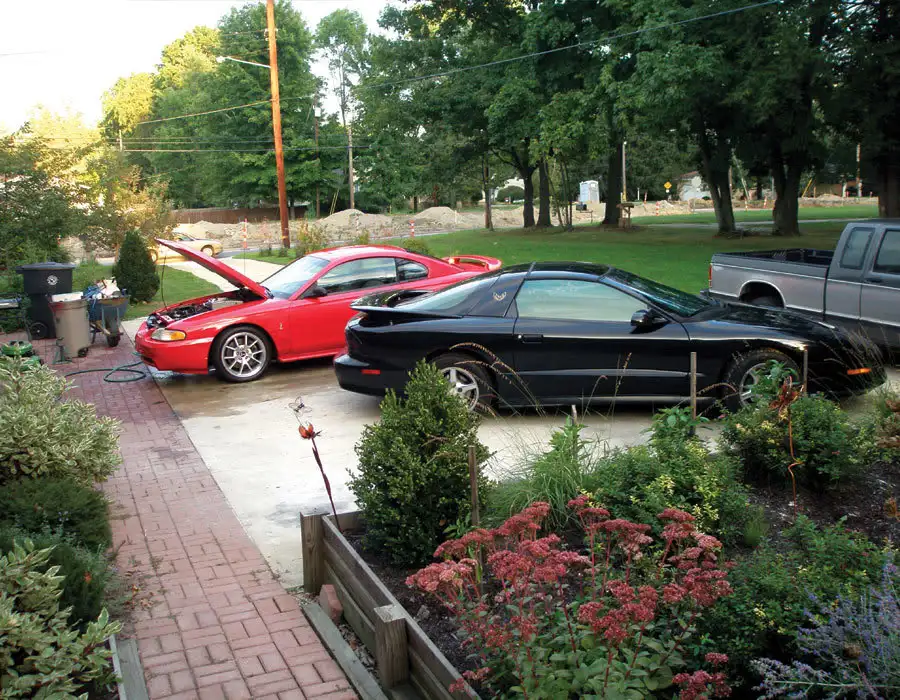

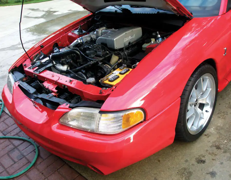

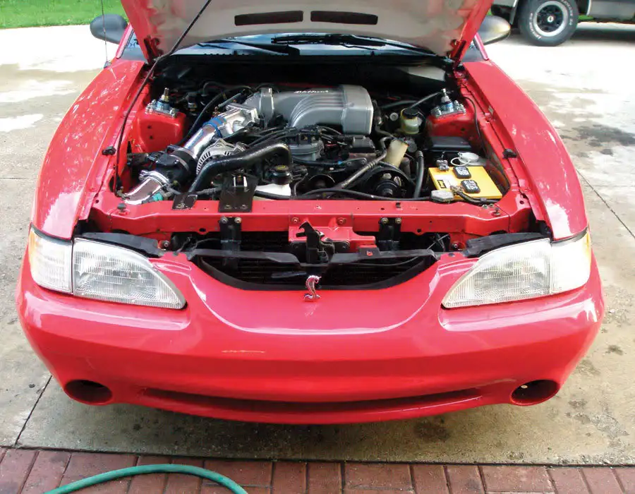

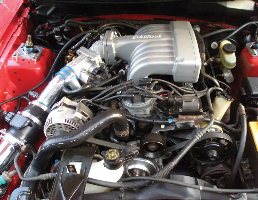

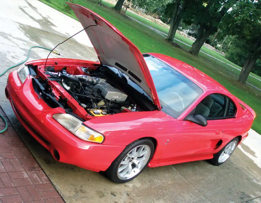

Few pics of the setup...plastic 'shroud cover' wasnt on in these..enjoy!
with the enemy....lol

Looking at your C&C plates:shock: . Mine appear to be identical except that you have yours rotated 90* and left to right reversed from mine. Just checked with my installation guide and mine are shown as being correct. Oval cutout running front to back not side to side like yours. Notice also in the install guide your orientation is correct for 79-93 mustangs. Just curious. Anyone else notice this:shrug: .
Interesting...I honestly believe I had them correct per included instructions, but I will check again tommorow. FWIW, its not exactly 'bad' it just won't offer the levels of adjustment if incorrect. I'll double check tommorow.
Good eye if thats true! :)
