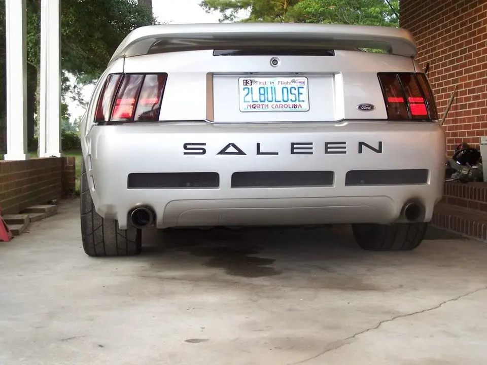

a pair of 305/35/18 MT;s will get you hooking!!!:D
Those look sweet, I love the look of the 315's from the rear but those dont look much different. How much a piece? I did find BFG D/R's 315/30/18 but I cant find a price for em yet.
they are close to $300 each, but worth every penny. my car will hook in 1st gear from a 5 mph roll with these and not spin at all between shifts. the BFG's are in the middle as far as traction. Nitto DR's suck, BFG's are good and last a while, MT's HOOK but will only last about 10K
