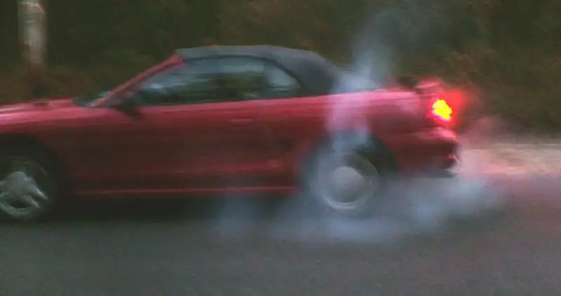

Finally isolated the grinding noise... it notmaly only happend when i was turning corners and accelling... But say i put the car in 4th gear going 25ish and give it some gas sure enough its there... i dont know what it is comming from though Trans??? Rear diff??? Drive shaft??? Anyone have this problem??? ANy help would be great... this is the only think thats wrong with the car besides the ping i cant put my finger on.... on a good note clutch packs seem fine.
Little dark...

i have the same problem especialy when there is smoke coming from the tire area, although my axle bearing is gone hehehehehe.
