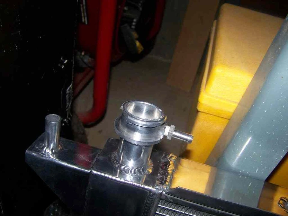

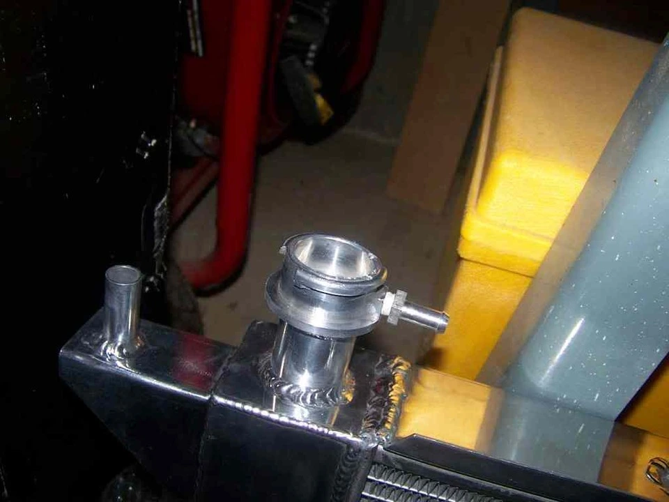

ums/dd51/davidpmp/000_1922.jpg[/IMG]
So is anything wrong with it besides the marks on the top of the neck?
I bet you could sand that out with some 600 grit wetsand paper then some 1000 to shine it back up. But then it might not seal good.
I will try to call today and ask about the 5% back. Who else besides Greet GT has received it?
He did state that we would get it before they shipped.
Well I finally got my rad and it looks great! It does have a very small scrape on the neck but nothing like David NC'S.
That is where the gasket is on the cap and it is the sealing point.
I don't think that the radiator cap seals on that surface anyway. At least I do not recall ever seeing a gasket there on one.
The top seal is required to seal so that the overflow vacuum is created at cool down. This suction, created at cool down, draws the coolant back into the radiator.
If not repaired, coolant will flow out the top defective seal and some into the coolant tank, but won't be drawn back up. I'd then be driving with a partially low coolant level in the radiator.
The two larger gouges are almost an 1/8 inch deep. Thes would require being welded over and ground down. The the rest could be smoothed over. Take $15 and about 3hrs time (travel & repair) and likely void the warranty. I've repair aluminum wheels with similar damage and would get $75. Don't have the tools or facilities anymore.
