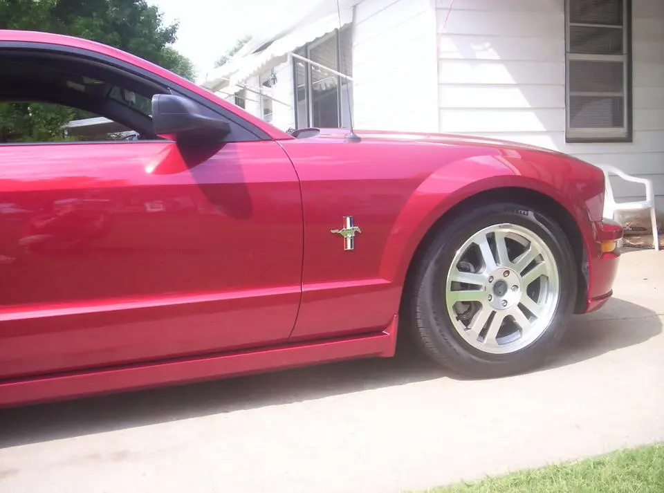

I replaced mine with the pony package ones, there are two allignment holes in each fender, the enblems have allignment pins on the back. Just heat them up with a hair dryer, you can use fishing line to run behind them or I used dental floss. Pull the badges off and clean the adhisive off the fender, they are stuck on the 3M tape.
