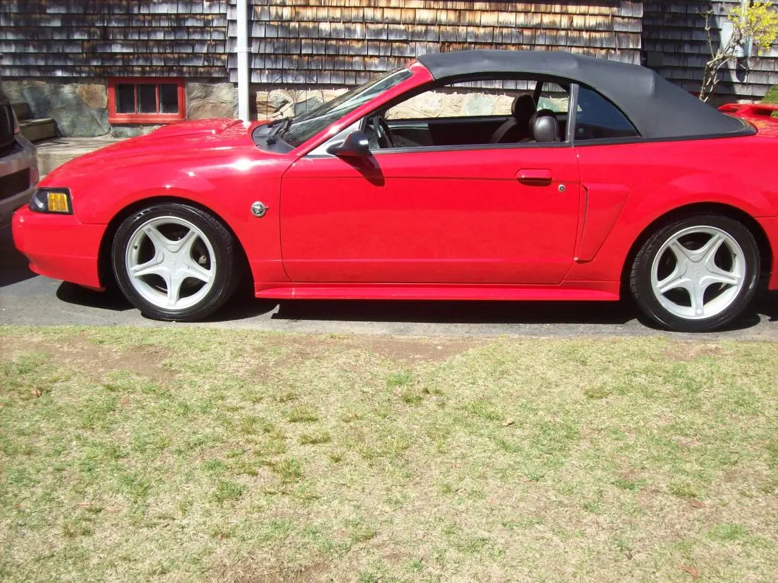

Received my springs from american muscle, I have a 2004 Gt convertible. Curious to see who is running them without the insulators and with. I know the drawbacks to both but I don't want to do the job twice, any suggestions and pics would help. Thanks

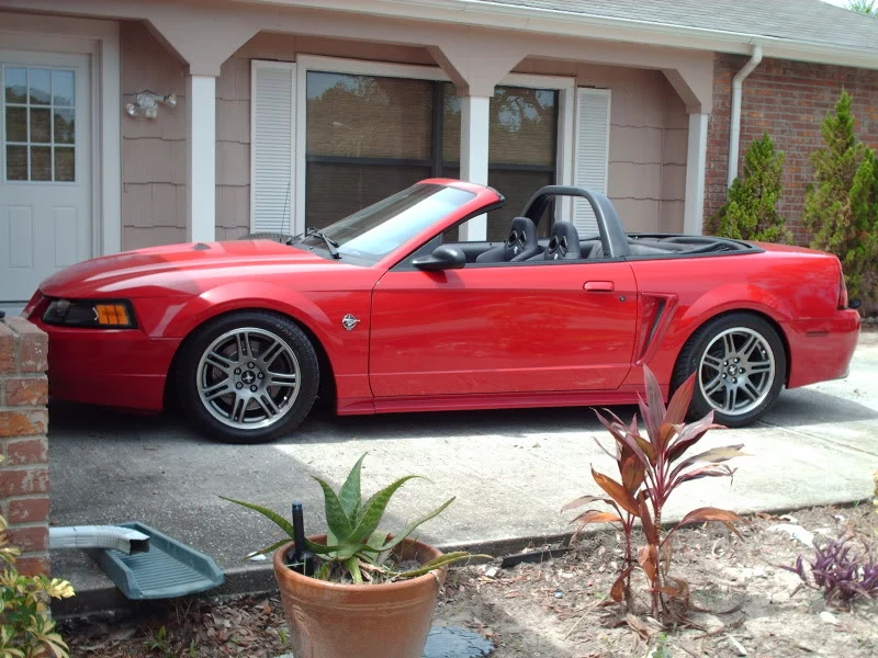

With isolators, but I do have x2 balljoints without spring spacers. So fronts are about a 1/4 inch lower than yours would be. Rears are Super Sports too, except for minor adjusting with my MM XD Adjustable Control Arms.
Hope the roads near you are good. The H&R Vert springs are rated for more drop than the Coupe springs. They come in very low even with isolators (as you can see). It was completely impractical up here in Mass. Constantly grounding out was no fun...:notnice:

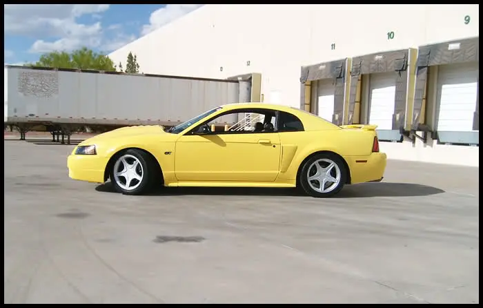

Nightfire that yellow is looking real good, that was my other color choice> i teke it you are not running the isolators then,

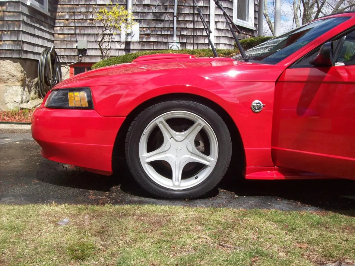

Beware tho mate... I REALLY dont recommend the H&Rs for MA roads. They SLAM verts. I had to remove my front springs and go with Roush instead because it was totally ridiculous! (my car is rarely driven also) Now I'm adding thicker isolators for more clearance. I'd go with Ford springs if I could do it again.

I remember right on the H&R website their vert springs were rated for more drop than the coupe springs. Dont know why.:shrug: 2.6" on the front I think. Fine if you live where the roads are nicely maintained, but up here with frost heaves and snow plow damage everywhere its not good at all.
I could barely get two fingers between the tire and wheel well and got fed up grouding out the K member or nose. I ended up being so paranoid about grounding out that I couldnt even enjoy driving it.:notnice:
