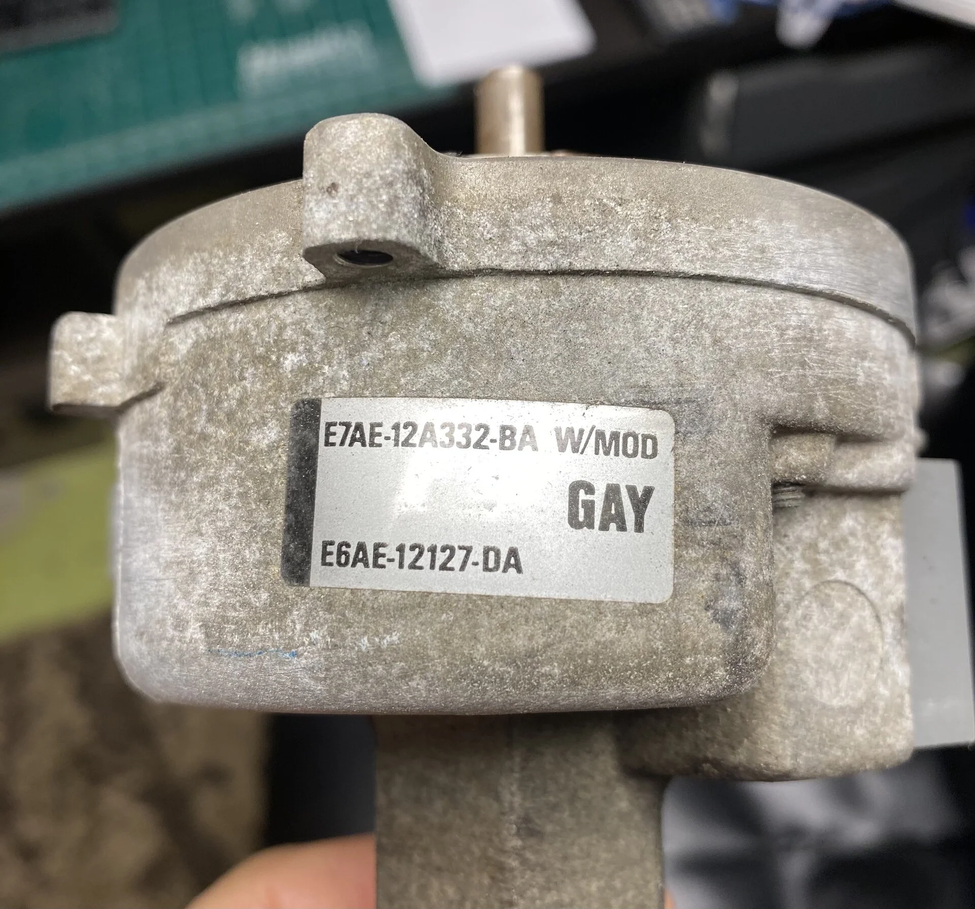

my distributor has the same parts number on the inside of the brownish orange thing.. not a mechanic... i have a 89 lx convertible 5.0 and the outside of distributor is e7ae - (cant read) - DA
89 L 2
E6AE 12127-DA
it also wont run with the firing order for the HO 13726548 and will backfire and sound like lawn mower.. but the old 15426378 firing order itll run really good..
That is the correct distributor for an ‘89 5.0 mustang.
this is the original dist out of my ‘88
