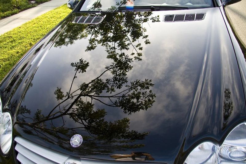

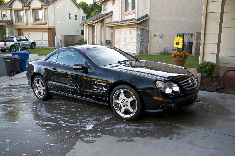

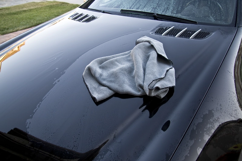

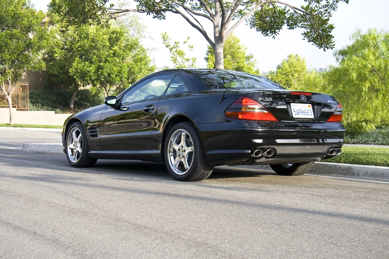

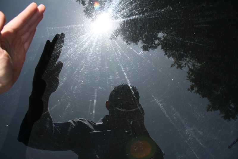

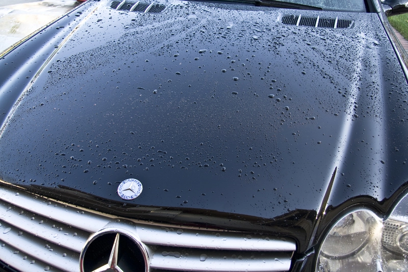

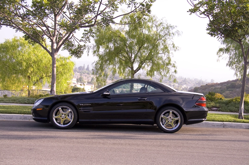

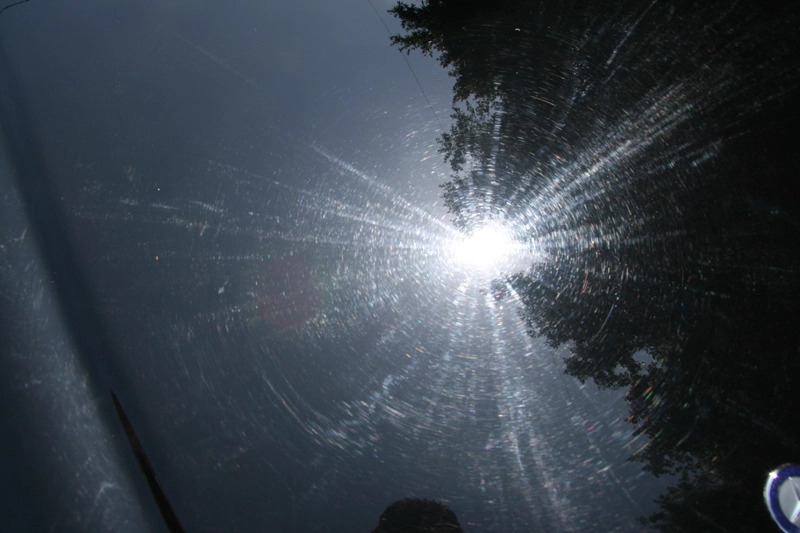

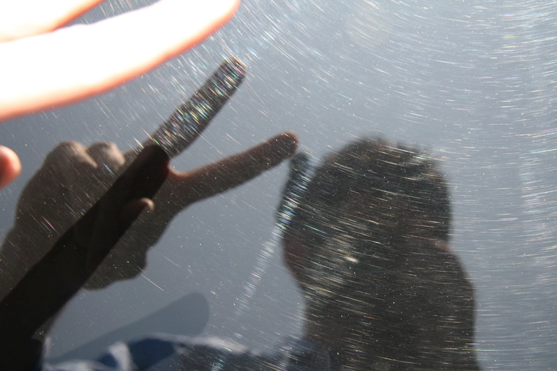

Grandparent Bought a 2003 SL55 AMG. The car was purchesed used and the previous Owner Really Neglected it. The Car had MAJOR swirl Marks from car washes and had never been waxed.
Products Used:
Adam's Car Wash
Dry With Waffle Weave Towel
Adam's Claybar
Wolfgang Total Swirl Remover 3.0 w/Lake Country Orange Pad
Wolfgang Finishing Glaze 3.0 w/Lake Country White Pad
Wolfgang Deep Gloss Sealant w/Lake Country Red Pad
Adam's VRT on Interior
Zymol Leather Conditioner
303 Aerospace on Enginebay
Master Formula on Wheels w/ Powerball
Before
After
After Polish Wash

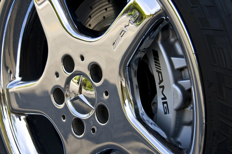

See thoes little grooves worn into the rotor? Yeah, thats wear. Now when a car olike that has that kind of wear you can tell he eaither went way past the schedualed replacement or rode his brakes, prolly overheating them. It might have a crack in one of them. Look at the front rotors closely and see if any of the holes have a small crack around them. Its a super fast car, dont wana risk bad breaks with the speeds that thing can do :shrug: Generaly AMG rotors cant be resurfaced, some can but I bet thoes cant. All its gonna do is add 10' to the stopping distance and might occasionally give some pedal vibration. The car is a steal even if it needs a complete brake overhaul :shrug:
