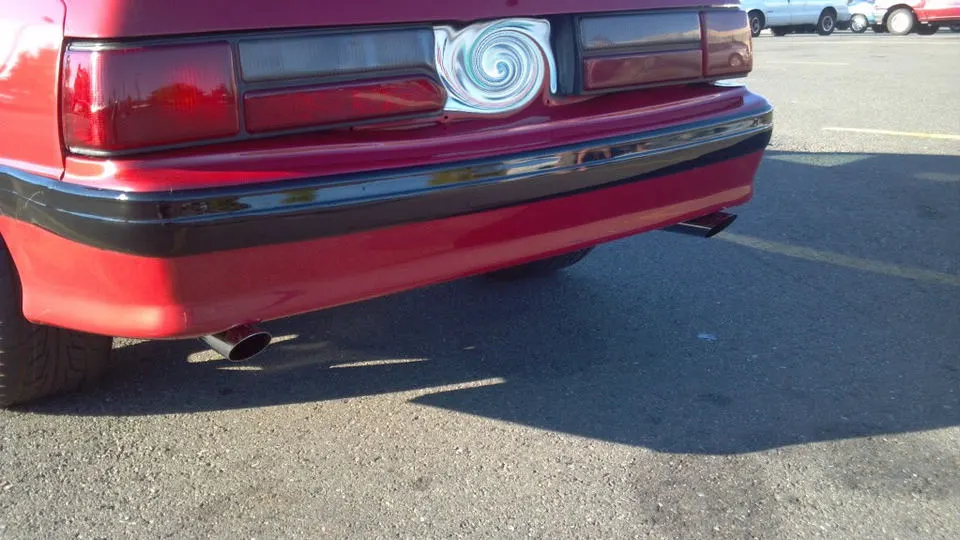

Either way, Im driving it to the exhaust shop tomorrow to have them finish putting up the H, installing some new mufflers and tail pipes for my cobra rear bumper.

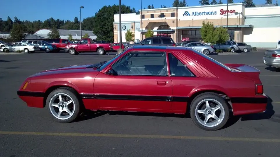

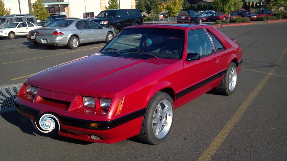

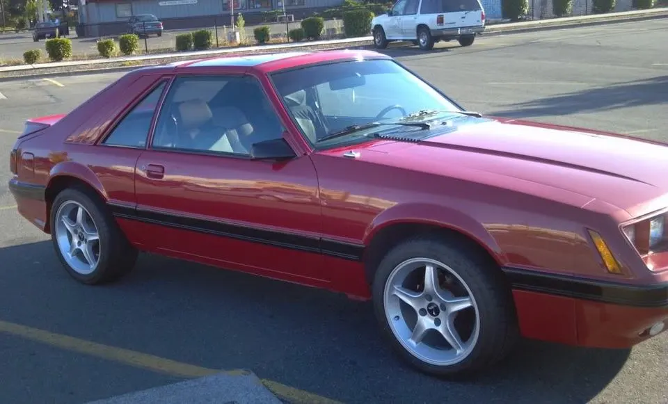

Well... even if the idle stalls at 2k then falls, it will still look pretty :rolleyes: Ill be putting up some pictures soon after I pick her up in a few hours and wash her.

AAAANNND as i said, i got pictures of her :D
