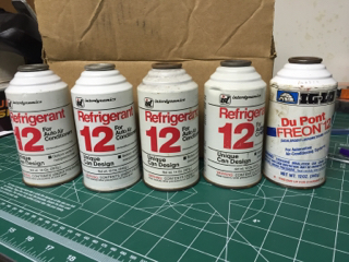

You can still get it on eBay. It's a bit more than $2, but might be cheaper than a 134a conversion.
I got my epa cert just to buy r12 and upon buying cans off eBay....not a single person asked to see it. I don't advocate skirting the law, but r12 is pretty available. I got mine for about $25/can.

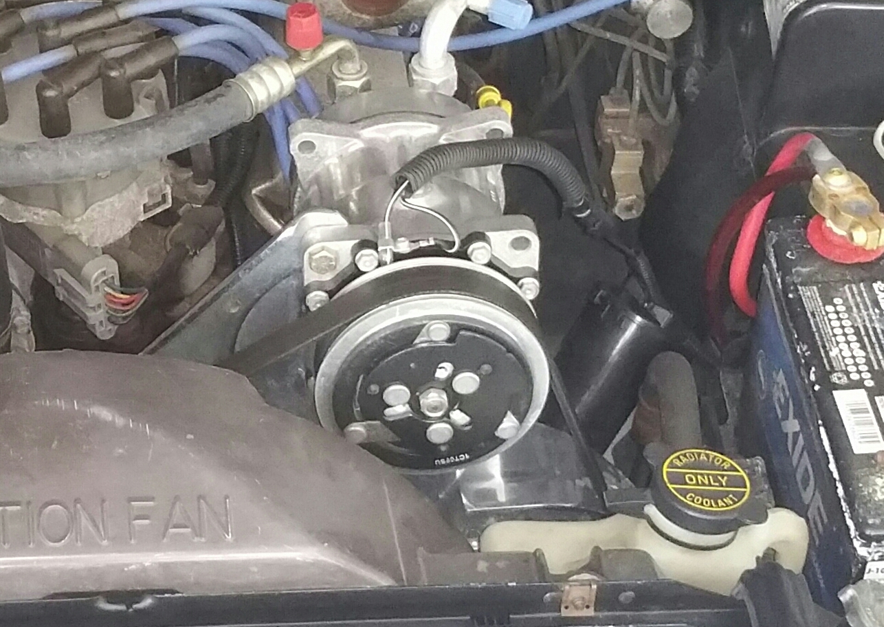

I did a R134a conversion on my 89GT, and used all stock parts. You will need to replace the dryer/receiver (about $75 if you get the one with the hose made as part of the unit), and should replace all of the rubber "O" ring seals as well. You will need to drain all of the oil out of the compressor and replace it with new R134a compatible oil.
R134 instructions (skip this if you use Freeze 12)
Keep in mind that to fulfill the requirements of the EPA, you are required by law to recover any refrigerant that still remains in the system. How (or wither or not) you accomplish this is up to you. Connect the charging gauge hoses to the service ports on the A/C (red gauge = high pressure, blue gauge = low pressure) and open the valves on the gauges to dump the remaining refrigerant (if any) into your "Freon recovery system", whatever it may be. Disconnect the charging gauges since you are finished with them until you are ready to fill the system with R134a. Next comes the nasty part – in order to get all the old oil out of the system, you will need to flush it with special flushing solvent, or mineral spirits (ok) or tetrachloroethylene (better, but may be hard to get). If you leave the old oil in place it will congeal and reduce the heat transfer in the condenser and evaporator (read that it won’t cool good) and possibly damage the compressor.
Disconnect the compressor and remove it from its mount to flush it with cleaning solvent. Pour about a cup of solvent into the suction port and turn the compressor center hub about 10 turns while shaking the compressor to move the solvent around inside the compressor sump. Drain the flushing solvent out and continue to turn the center hub by hand to force out any remaining solvent. Then fill it with oil: add about 6-8 oz of the new oil to the compressor large suction fitting. Turn the compressor center hub about 20 turns as you turn the compressor face up and face down to distribute the new oil inside the compressor. Catch and replace any oil that comes out of the compressor.
Connect the pump (I had an electric sump pump I bought for $20) to the hose from the high-pressure side of the compressor. Alternately, you could use compressed air to force the cleaning fluid through the system. I didn’t like to do this since compressed air has lots of moisture in it, which is death to A/C systems. Pump the cleaning fluid through the system and let it come out the hose that was attached to the old dryer/receiver. I used 2 gallons of mineral spirits and pumped it all through the condenser and evaporator. The expansion valve is located near the firewall in the high-pressure line of the evaporator, and may cause the cleaning fluid to trickle through the lines at a very slow pace. You may want to pump cleaning fluid through the evaporator and condenser separately to speed up the process.
