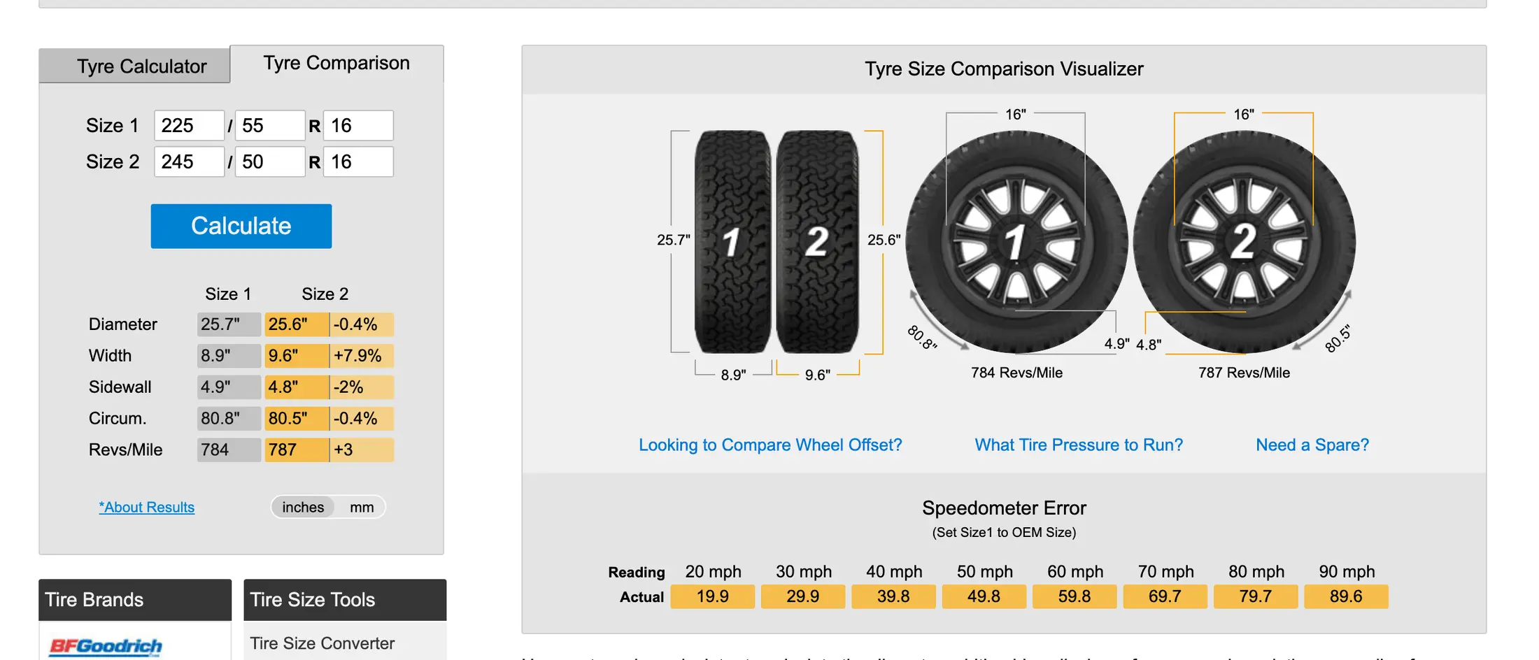

225/55R16 is the stock tire size, but according to LMR, that size would require an 8mm spacer up front and may require flipping rear shocks.
Some folks in older threads also mentioned 245/50R16 without issues. But those are only 0.1" shorter sidewall, not sure if that would be enough to alleviate any rubbing issues.
All that said I'm wondering if anyone can give insight on the older models specifically from the square headlight era which I now believe has smaller fenders.
225/55 vs 245/50:
I've also seen a few threads where guys are running 225/50 (instead of 55) up front and stated that it doesn't rub, but that was on an 89 which I believe has wider fronts.

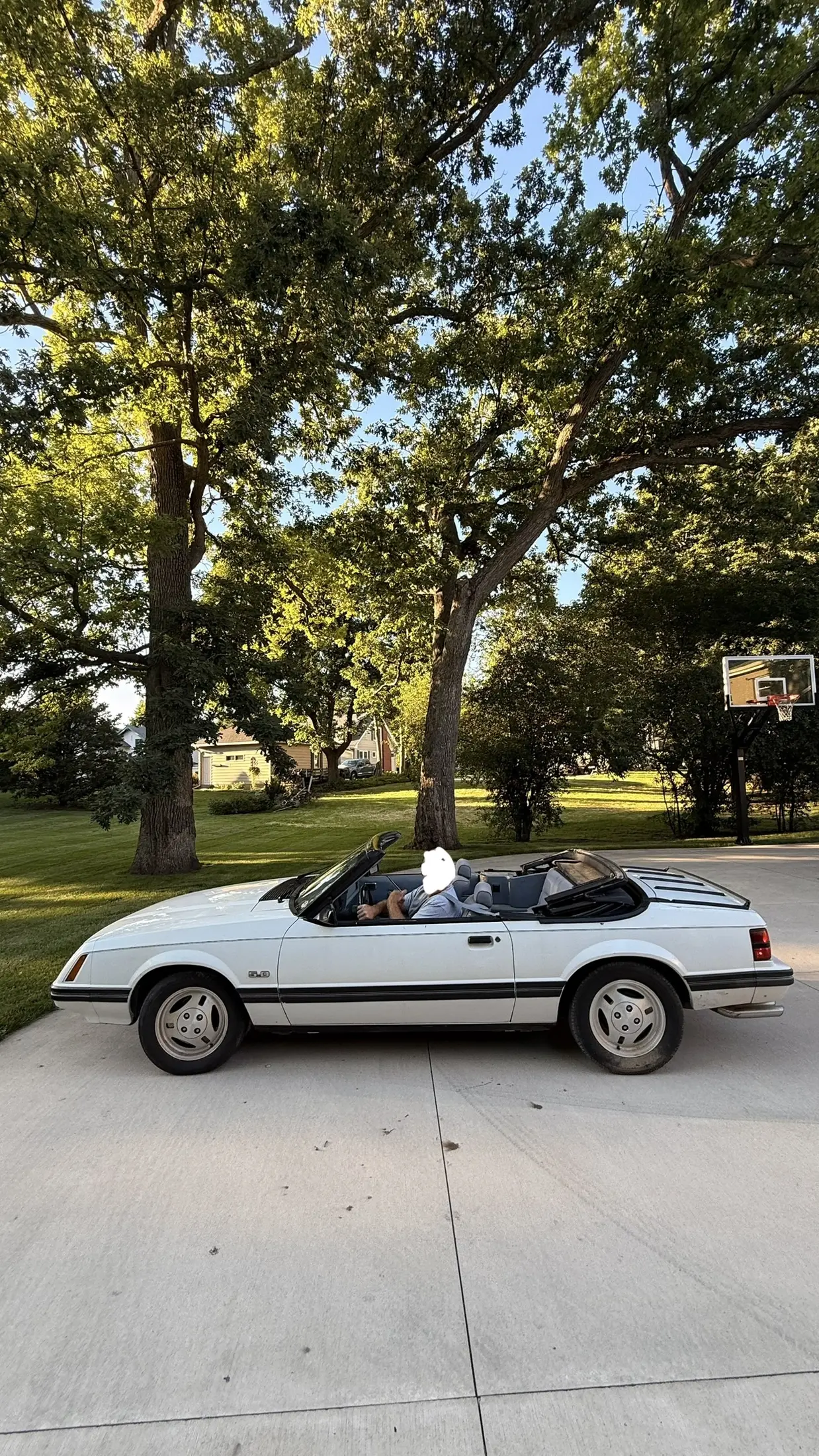

Here's the car!
225/55 vs 245/50:
Here's the car!
