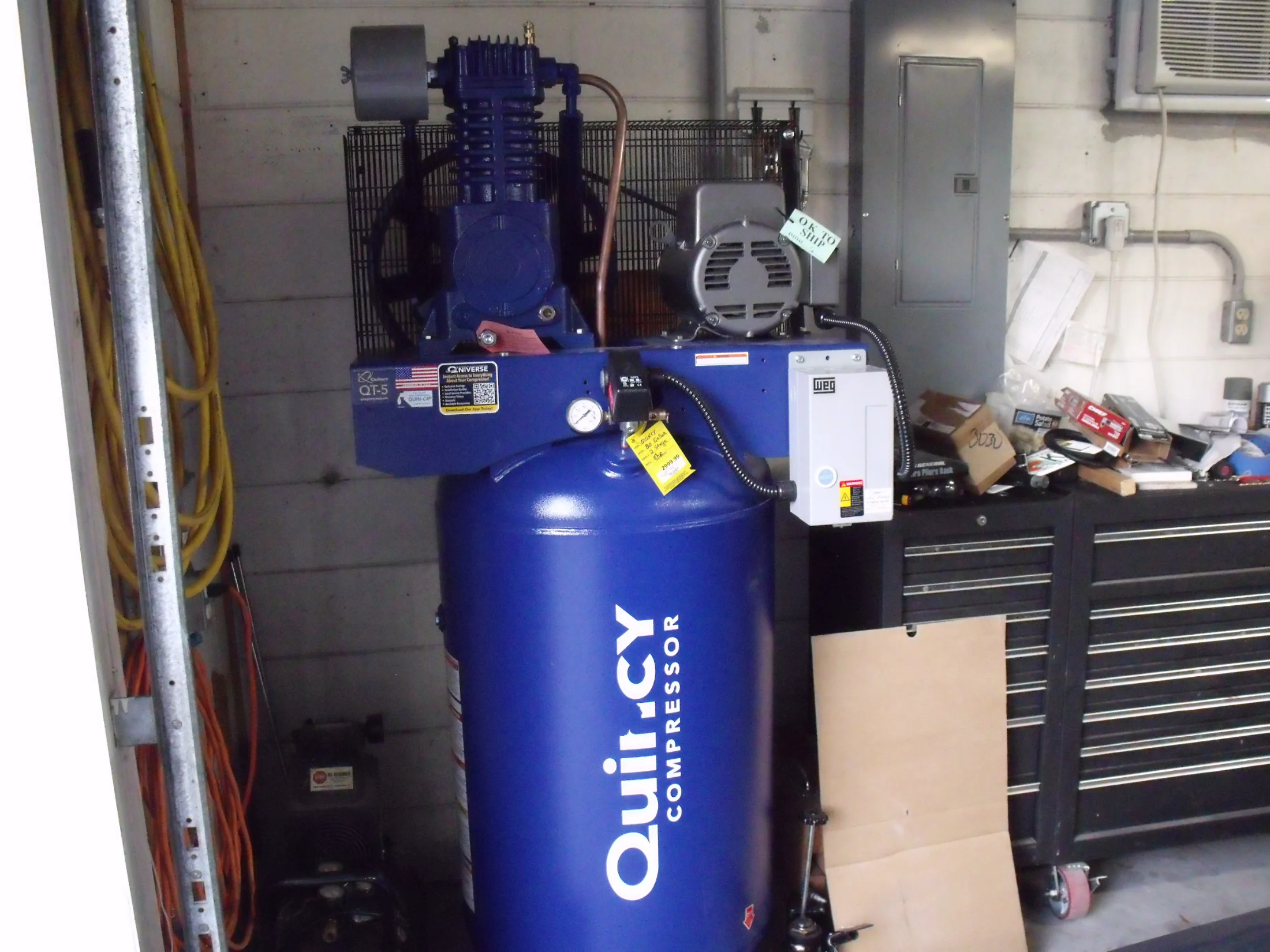

Maybe a picture of my new compressor will help...

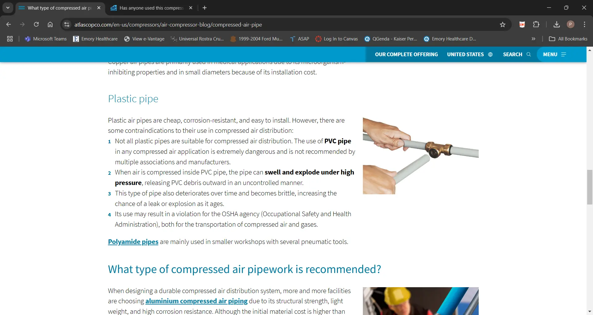

I was around a PVC system years ago that exploded..... No thanks, do it right do it once...
alot of PEX recommendations too..... But its an unsafe system to use with high pressures...
If I dont' use this system I will used Galvanized ( its too humid in florida for Black Iron pipe) or copper....
EDIT:... I just looked up some schedule 40 PVC pipe pressure testing and it would handle the 150 I plan to run in my system... 450 PSI for a 1" PVC Schedule 40 pipe....
