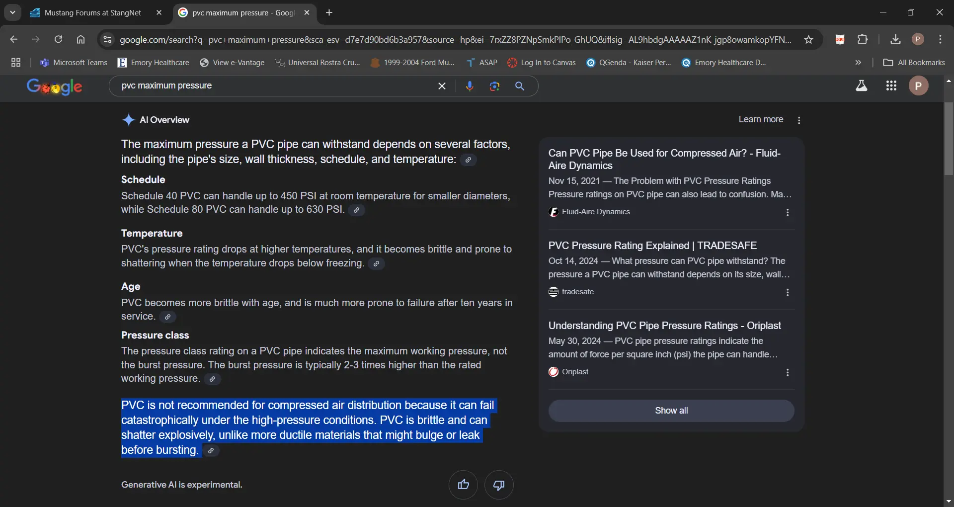

Here is the thing with PVC Schedule 40 or 80:
It expands and contracts until it pops. It could take a year or 10 years Most PVC is made for a specific purpose and largely constant pressures at lower pressures.

Good old Google AI....
I dunno - I think I'm with @limp on this. Do it once and never have to worry about it. I mean I've seen it used in a couple different places, but I don't know if I'd want to be standing next to a line that decides to let go at some random time.
