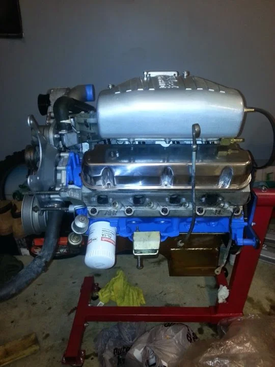

I just put 9333's and ARP studs on my motor. I'll post another pic because sex!
