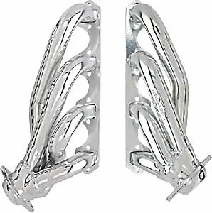

These. Ford Racing Stainless Shorties. Lifetime Warranty and Real "Jet Hot" coating.
