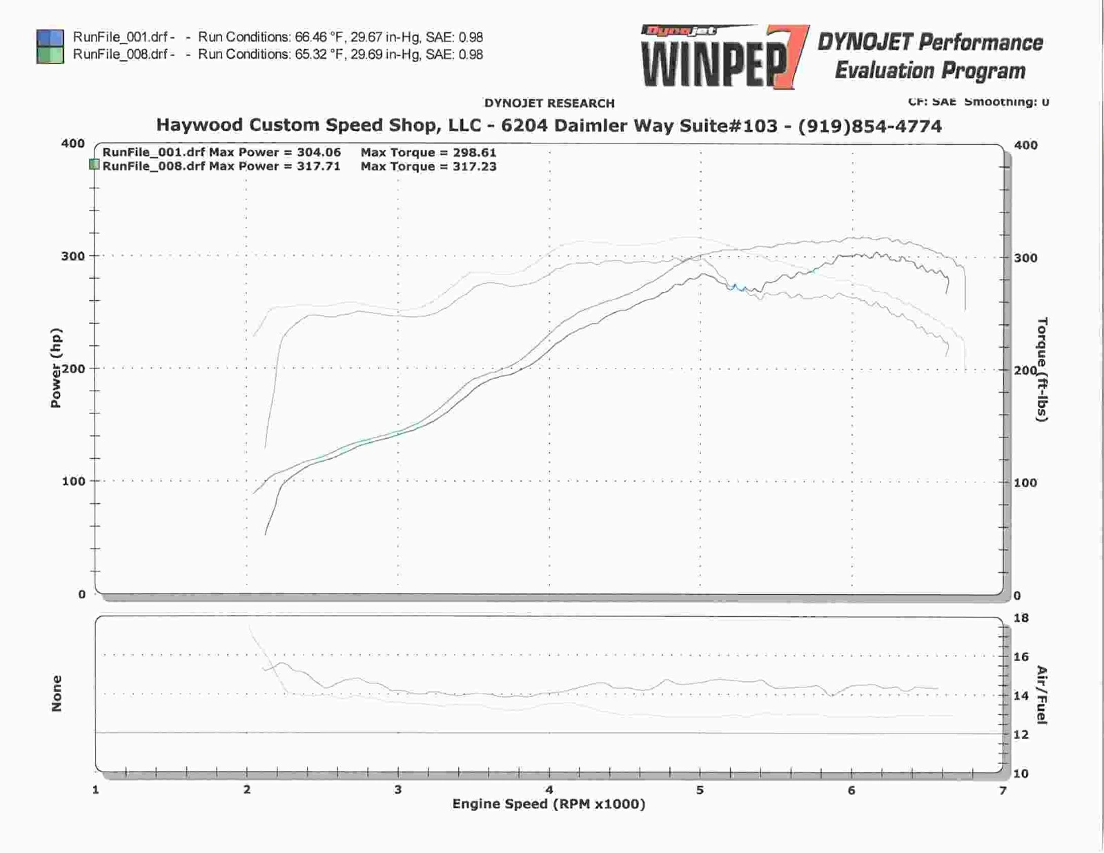

Here ya go - before and after JBA 1 5/8 Shorties. Looks like 13.65rwhp peak.
Not too shabby for shorties. Of course you may not see as much with just JBA's because of my additional mods (ie 87mm MAF, Densecharger). Yeah, had a dyno tune before and after by Randy Haywood. He's the best I have found, and the only one I'll let touch my car - besides me. I hope this jpg attaches...

so what that dyno graph shows is that tuned right and with a couple of other mods, you can get a good gain with a pair of high quality headers
therefore, JBA Headers = teh win
