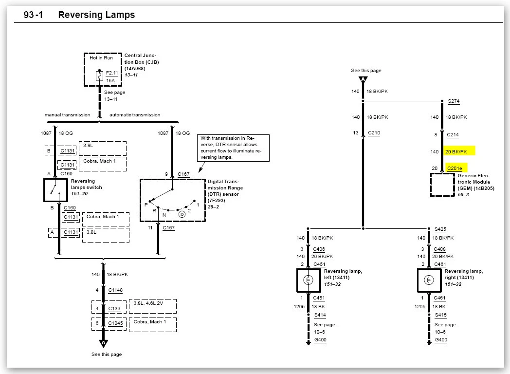

Ok so I recently bought a backup camera with a monitor and I've been told to connect it to the reverse light. I can't for the life of me find out which one that is when pull out the back light. Someone please help. And remember, I'm not very knowledgeable when it comes to cars so keep this in mind when explaining to me what to do. THANK YOU!

I won't promise I'm correct,but this wiring diagram lists the reverse light as the black/pink wire. And you may be able to access said wire behind the passenger front kick panel. If not there then at the tail light it self lol.
Hope this helps, I'm sure others will be in to correct me or offer other advice ..
