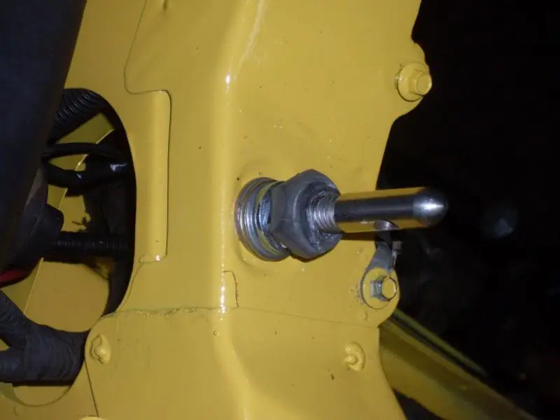

I believe me and a friend had this problem on his stang, we just went down to ace hardware and got some longer screws. Although I think he ended up getting the first ones to fit after that.

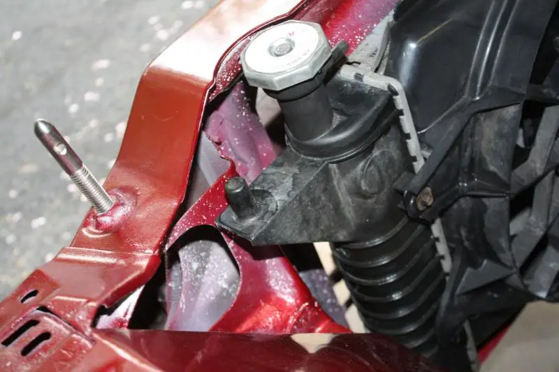

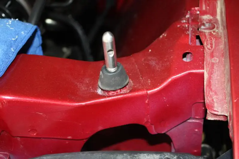

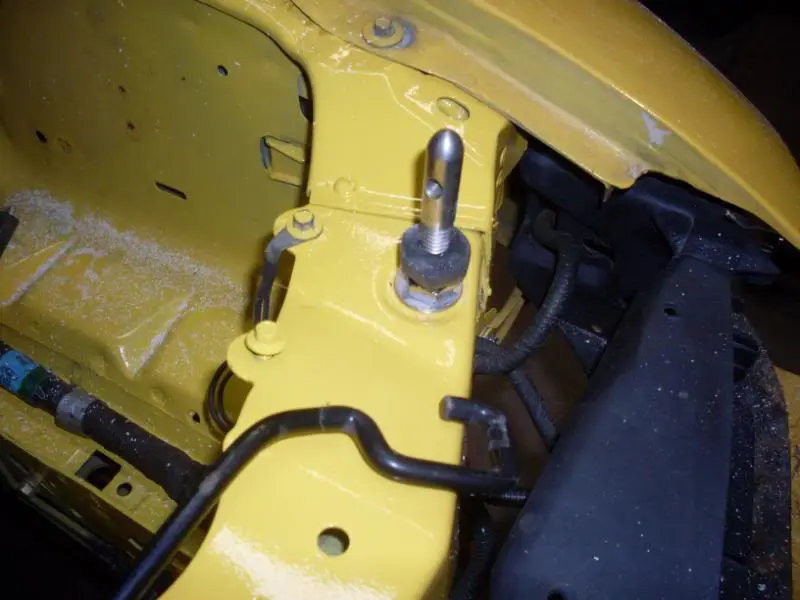

I welded my top nut to the metal... just tapped them lightly with a rubber mallet to straiten them out.
i lost my stops so i used ones from a FC rx7 we had in the yard.
i cut a small slit in the underside of the hood to get the striker plates inside. then riveted the top plates in place

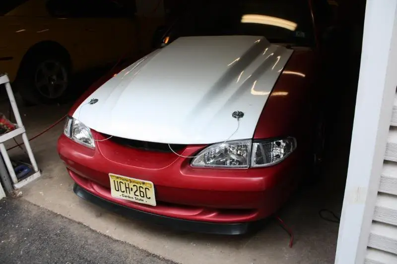

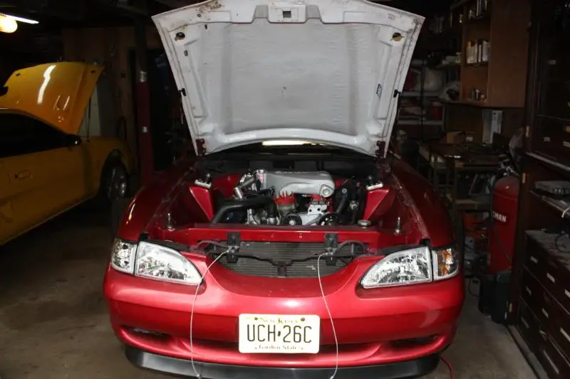

i just looked i have no better pictures of the underside but im pretty sure thats the way its to be done... im just going to reglass over the holes i cut to get the plates in... get some stainless rivits for a better look then the screws...

in order to get the pins to go in the hoods without scraping you need a decent sized hole anyway... Bigger then the pins at least to account for the angle of hood opening and closing. so all you really need to do is cut 2 slits... re-gassing inst hard at all plus it reinforces the area...
i wish i had underside pics of the cobras hood.
here is the finished product:

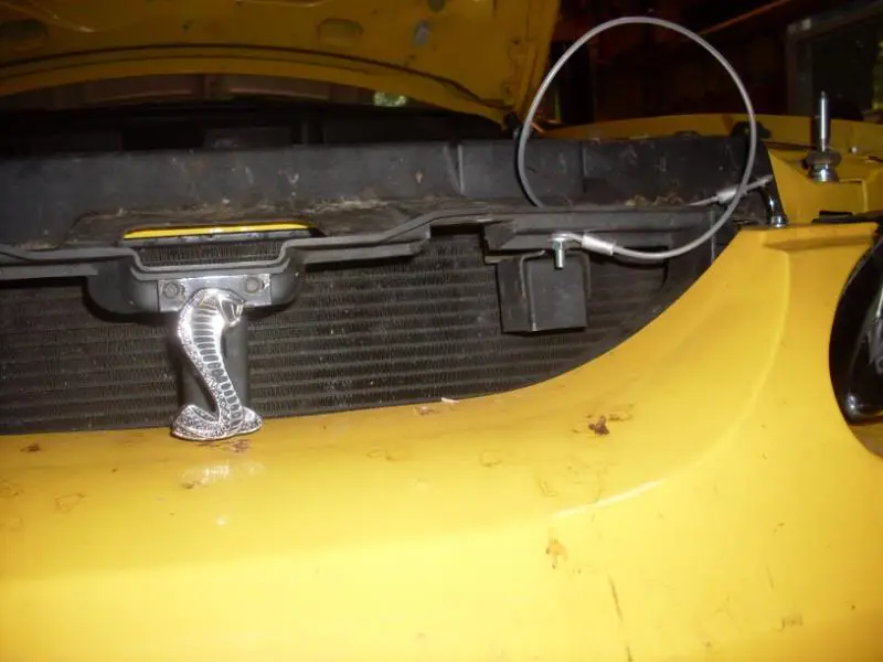

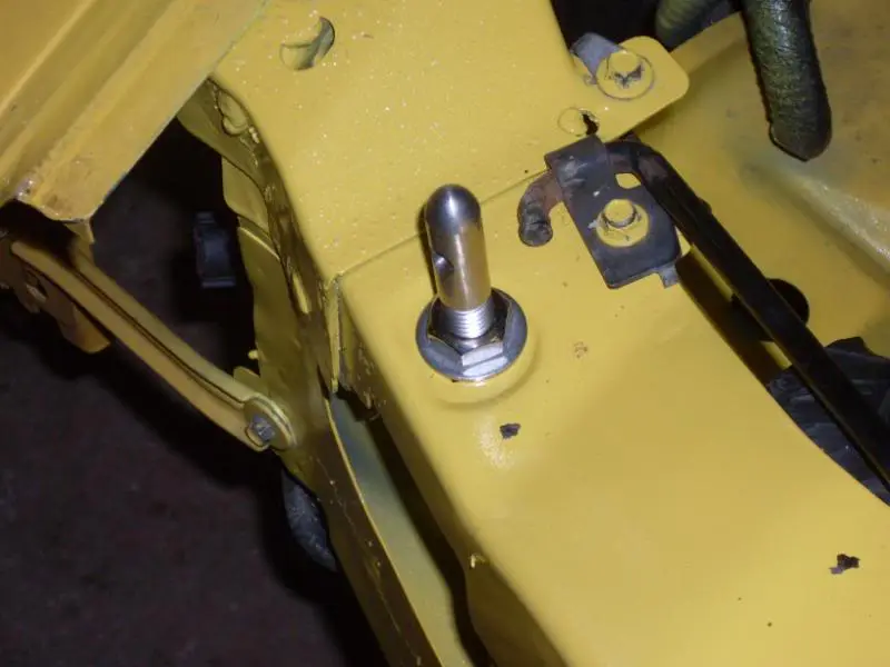

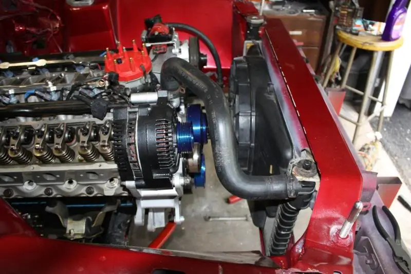

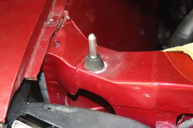

All done...... a little over 2 hours. Also, I fabricated two "L" brackets at work and bolted them to the front of the radiator support directly in front of where the hood bumpers are mounted. I then installed the pins through the brackets. I did it this way so I could keep the stock hood bumpers. Turned out great!
Thanks to everyone for your help!
-Wayne

Actually, this set in fact does have 2 plates that are supposed to live under the hood and are screwed from the top through that plate. I didn't end up using them though. I just screwed the stainless plate right to the hood.
The two plates i'm talking about are very different from the one's on top. (not shiny, etc.)

Here is what I did:

Oh yeah, the stock hood latch is still being used. I would actually have no problem trusting the brackets though. I made them from 1/8" steel and bolted them to the support with 1/4" bolts. I suppose they could be welded too, I probably would if I weren't keeping the stock hood latch.
