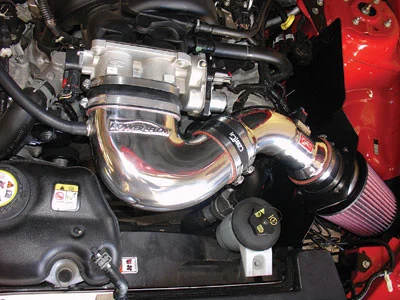

I ordered the PF9025P INJEN intake form BlowByRacing. It will arrive this week. Doesn't require tune - looks great! They offer polished and black
