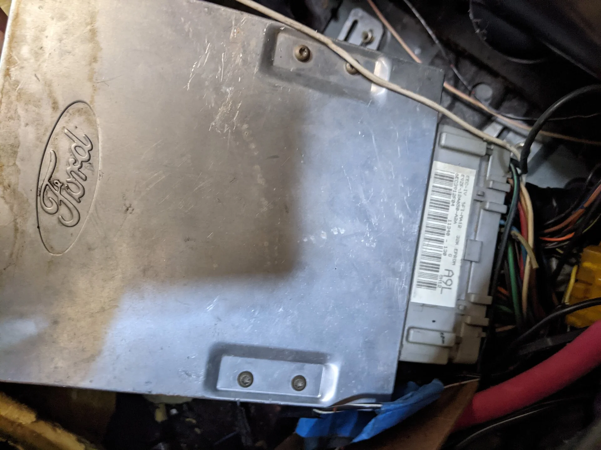

So I'm starting to feel like the guy who had it before me cobbled it together. A9L ECU on a pre HO motor would that work? It would explain why it doesn't run right.

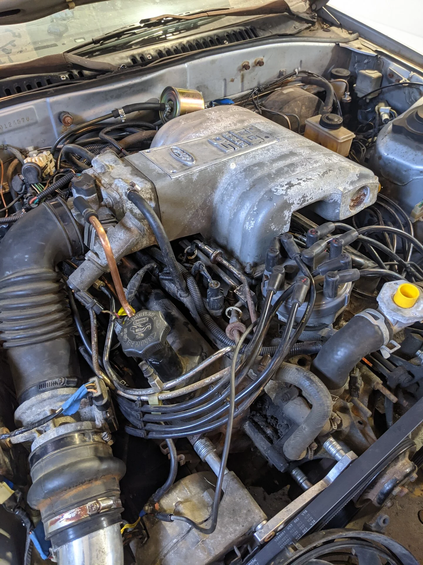

What car is the motor in? Cowl area is not Mustang. Also, fuel filter between intake and firewall scares me (it might work but personally I find scary).
I would agree, non-HO. Oil filler tube looks odd as well, almost modified part way up the tube (or just something with the pic).
So moving forward the A9L ecu goes to the HO motor right.
It doesn’t go with a specific engine, but rather a combo of parts.
in this case, a HO firing order cam and 19# injectors would likely get it running.
from what I can see, those are the gray #14 pound injectors.
I have seen guys get this setup working by rewiring the injectors to the HO firing order. I believe two pins will need to be swapped at the ECU. But, you’ll need 19# injectors
hack I know…but gets you running better
